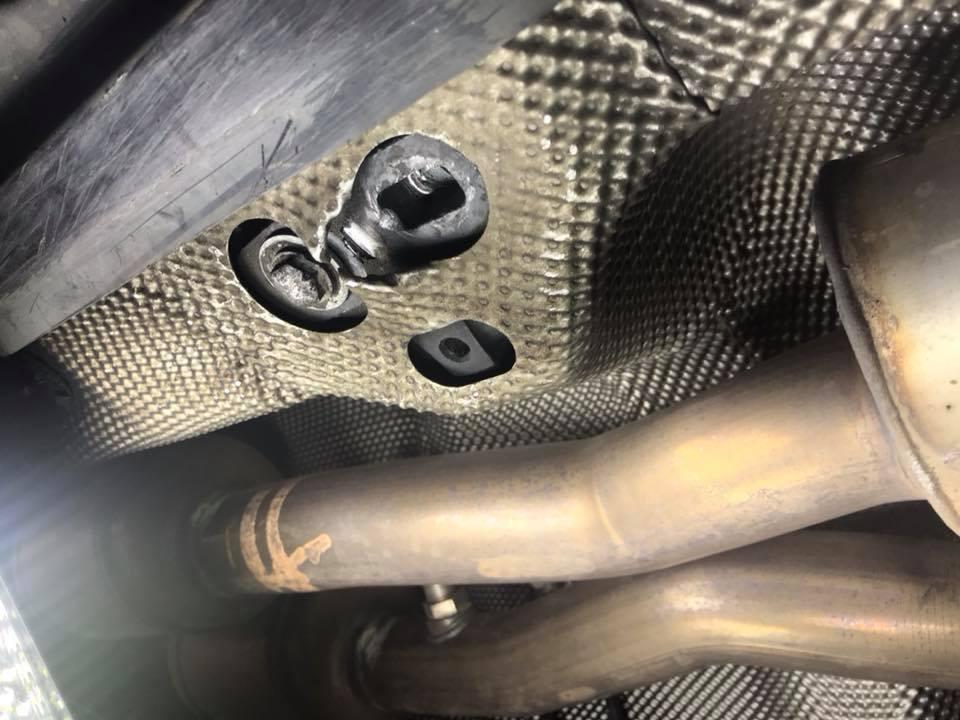

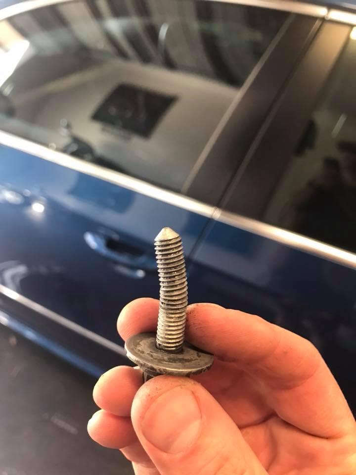

I assumed it was the exhaust scraping and didn't worry about it too much. This morning it scraped particularly badly and I saw half a bolt get left behind. I had previously found half a bolt in a similar position but wasn't sure where it had came from.
So I investigate and find that the carrier bearing for the tailshaft has 2 sheared bolts and one bent as ****, leaving only one good bolt keeping it secure
I cbf'd with an easy out so I rang the good people at volkewrke who squeezed me in on what was already a flat chat day before a long weekend. The kids and I went over to Doncaster shops and had some lunch while the boys extracted the 2 broken bolts and replaced the lot with new high tensile bolts with lower profile heads. Love their work!
