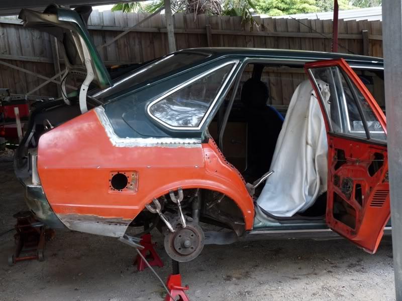

The inner guard took a fair whack.

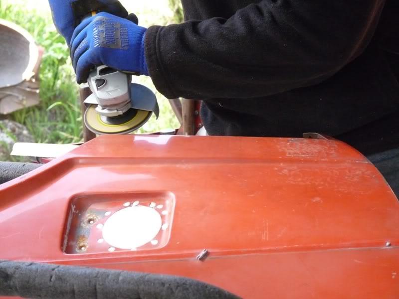

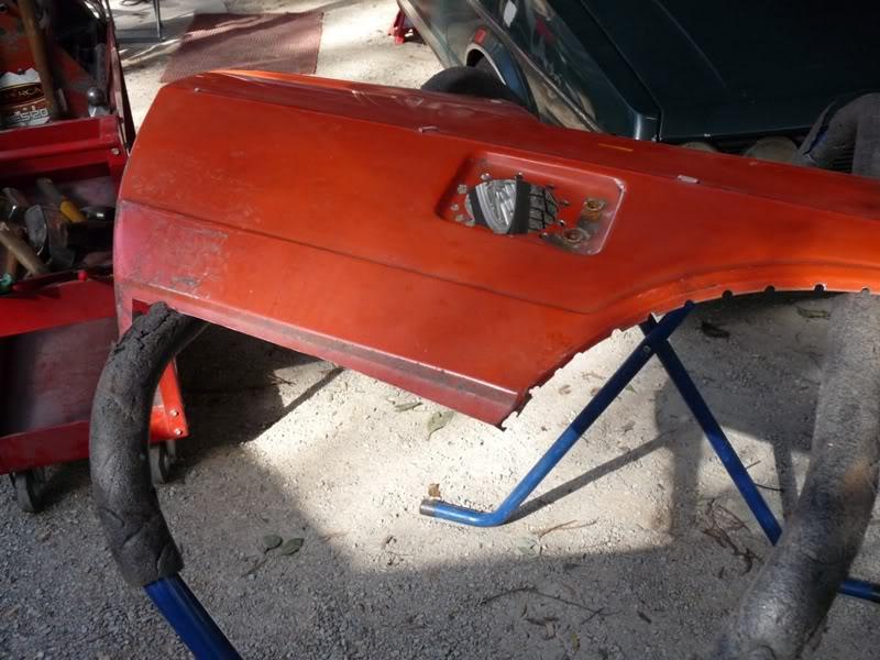

The idea is to trial fit the new skin up and bring the inner guard out to meet it.
Lots of adventures with clecos (skin pins) tomorrow.

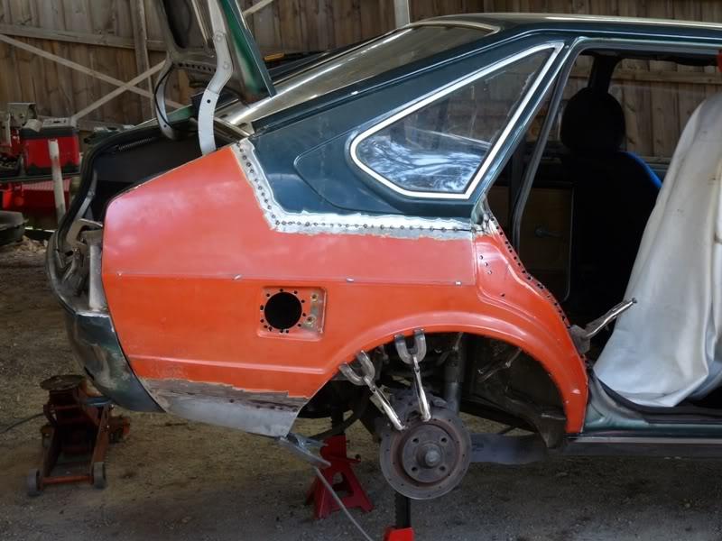

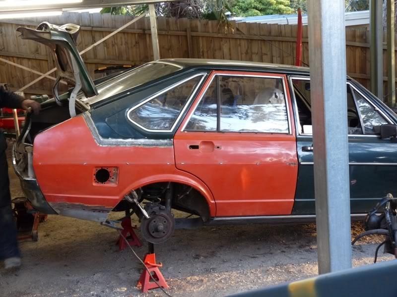

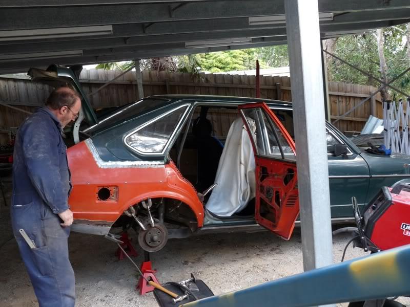

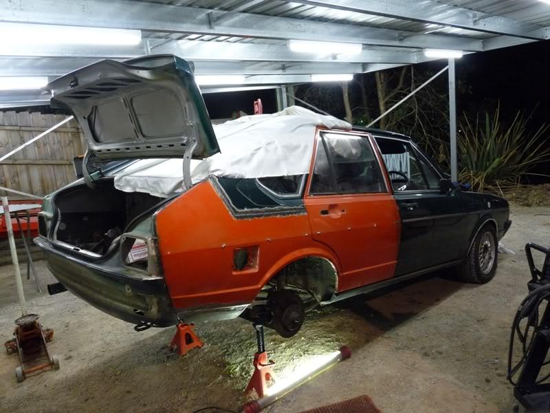

Progress slowed today. The inner guard is defeating me at the moment.
Got the fuel tank out because it's a bit too close to where I'll be welding.
Fitted and adjusted the new door which took a bit of stuffing about. Passat's don't have the greatest range of adjustments.
I won't get much done next weekend due to Phillip Island, but the weekend after that should see it done.
Then it's on to painting which should be an adventure.
Need to get this on the road before DOVW.

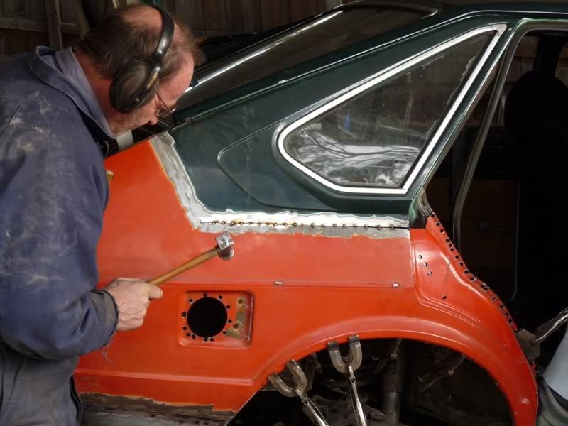

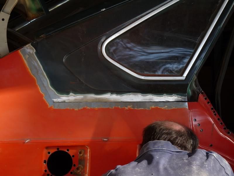

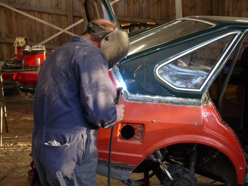

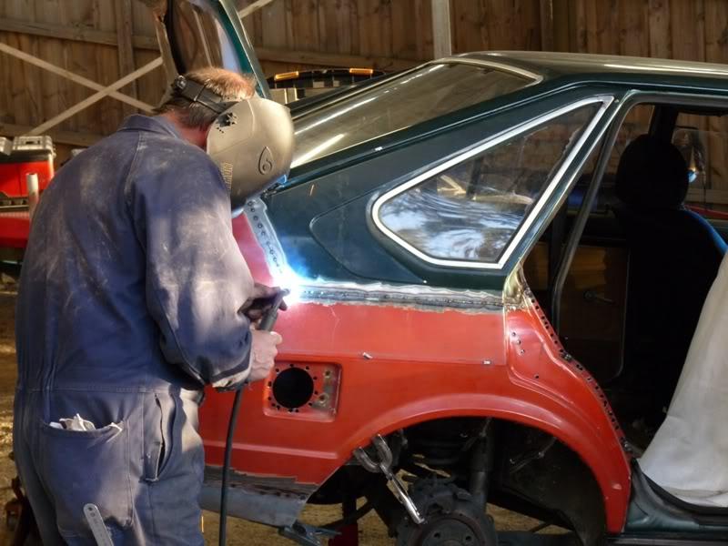

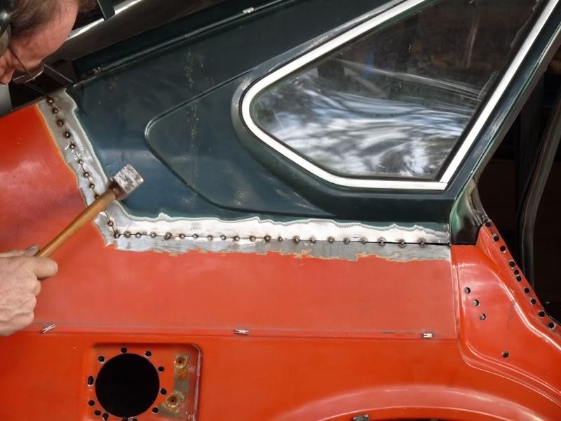

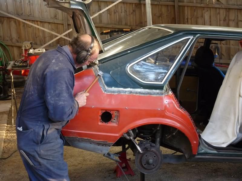

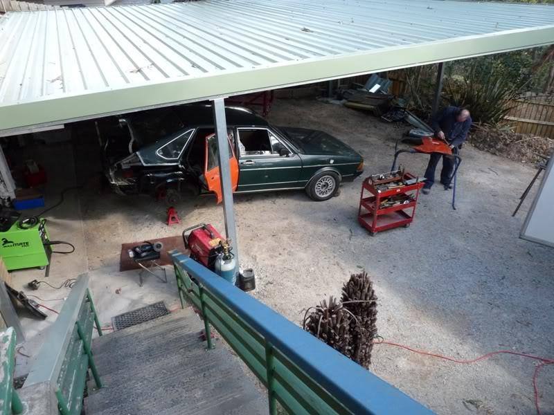

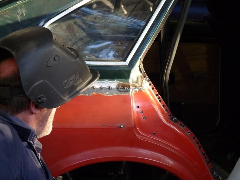

After staring at the new panel for hours trying to figure out how to tackle it I realised this was probably beyond me and called for help.
Dennis is an old friend of mine and is one of those old skool metal smiths that are rarely found these days. He took some time off fixing Ferrari 360s to get me back on track.

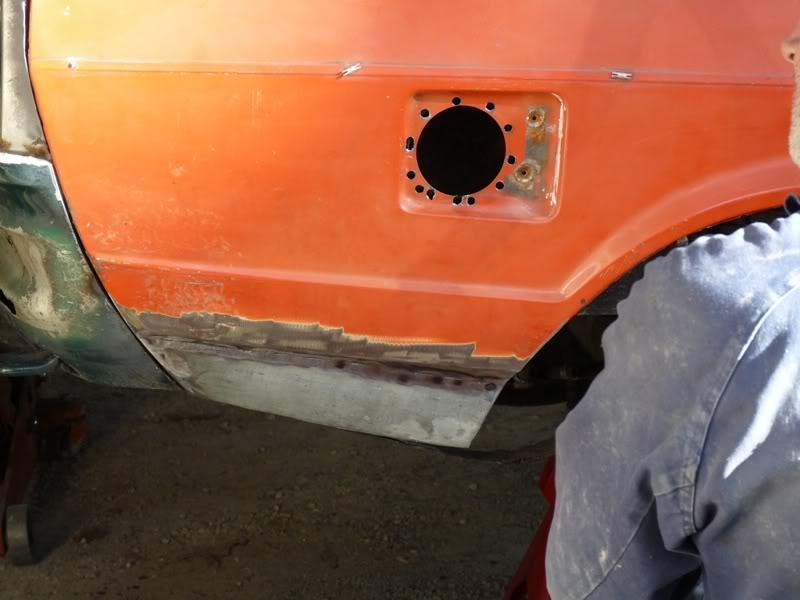

The bottom corner of the guard had a rust pinhole in it, when I cleaned it up with a wire brush the panel started to disapear. It was mostly rust held together by a layer of paint. Dennis said he just have to put a 'piece' in there. Before I knew it he had fabricated a new corner to the guard!
Watch and learn.
Most of the morning Dennis spent straightening out the inner guard. I hadn't even got it close.

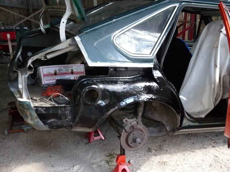

Here it's been etch primed and painted before the outer skin gets attached.
7? MK1 Caddy
79 B1 Passat Dasher Project
12 Amarok

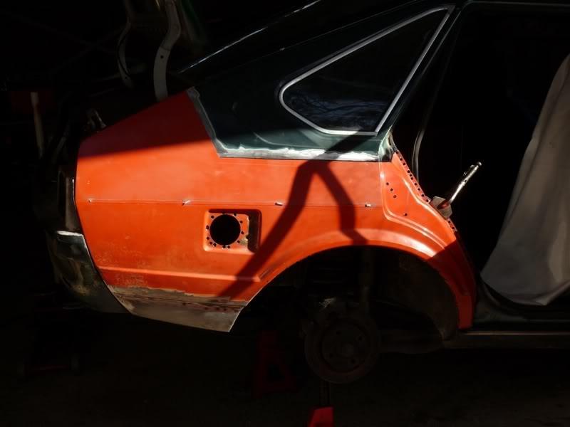

This is where I've left it tonight, just a bit of etch primer and high fill on it to keep it from rusting. I've seam sealer'd the interior joins and the inner lip on the guard.

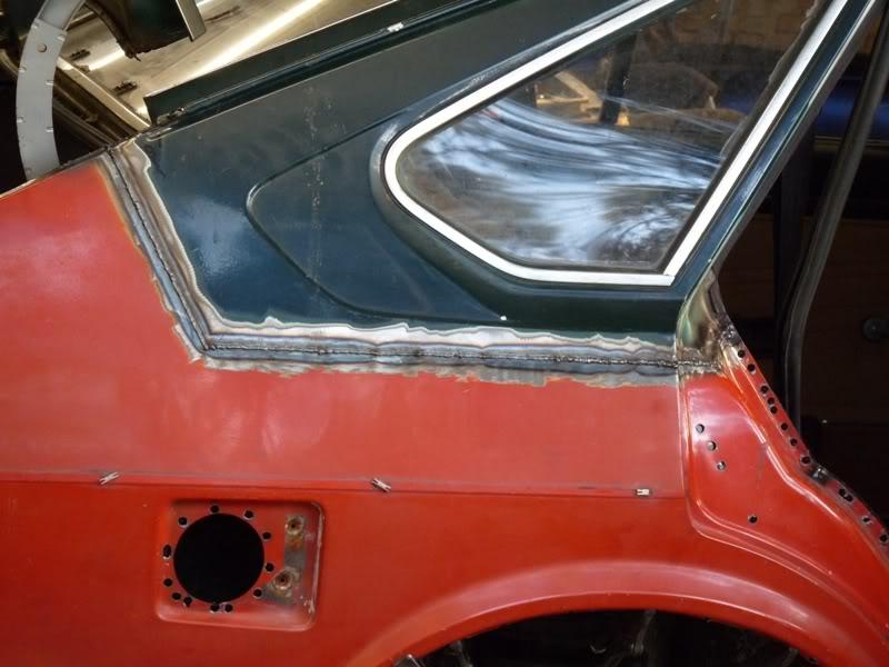

The welds are so straight! Amazing.

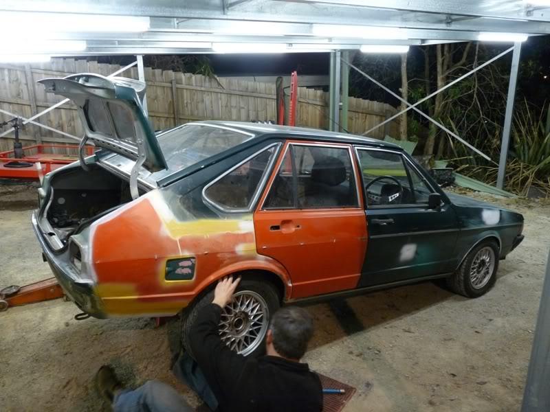

Fantastic work. Slotted disk brake rear end! Tell me more please. Bridgestone Adrenalins as well? Love the rims, a bit easier to clean than mine as the meshing/cross hatching is finer and yours look in great condition.
