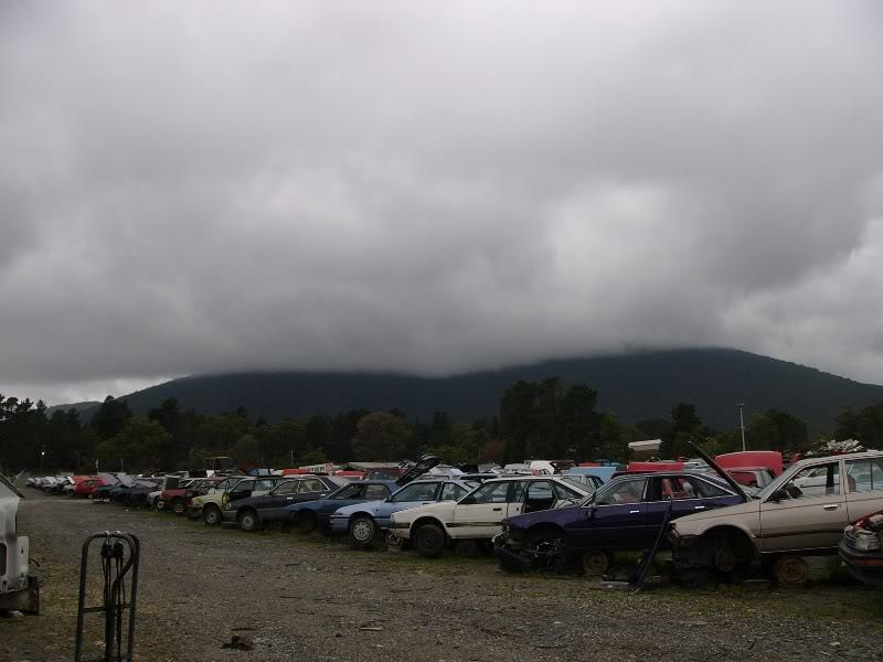

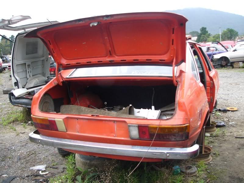

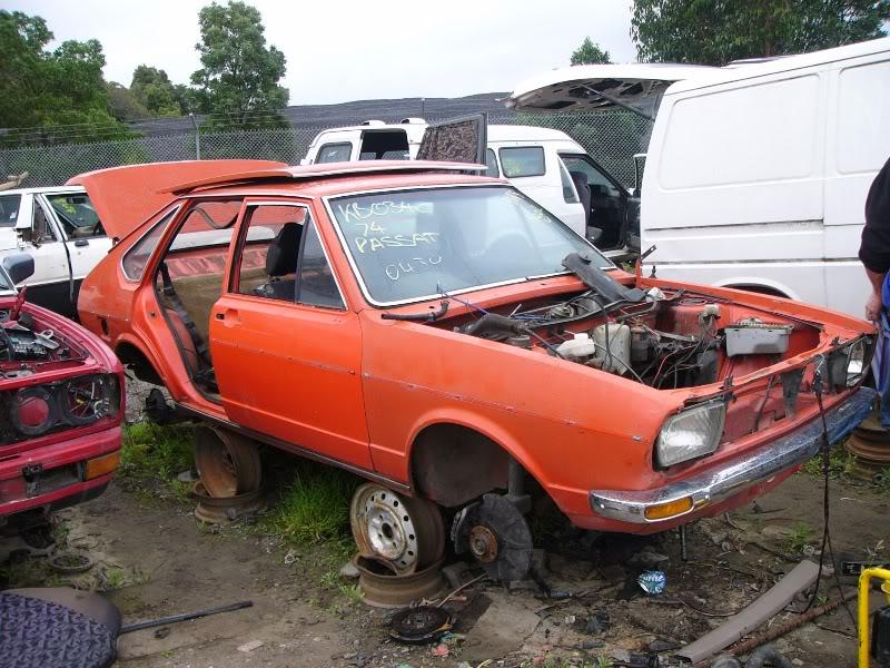

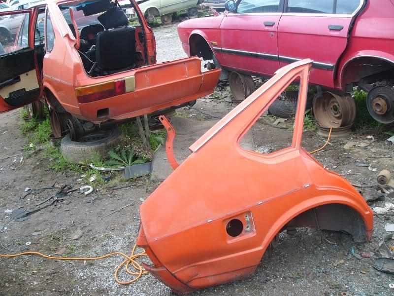

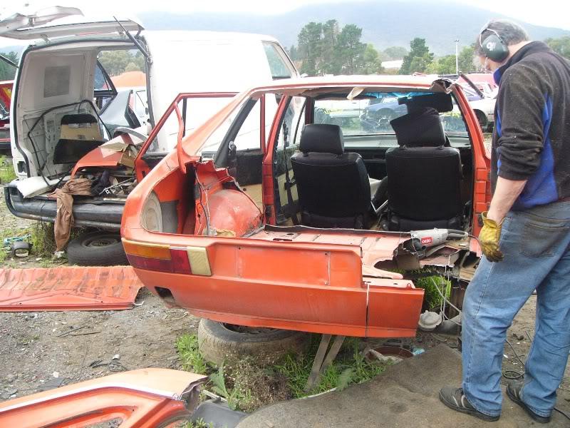

Went and got another 1/4 panel and inner guard yesterday. It's off a 74, there's a few minor differences but I can work around those.
Very scenic wreckers yard this one!
I was a bit worried about the impending rain.

ahhh ye olde 9 inch grinder at work aye
awesome Pete

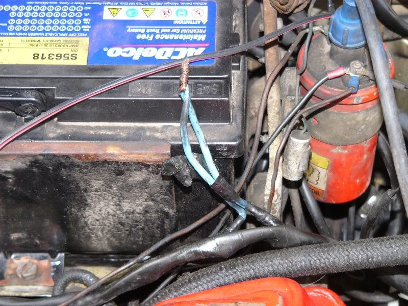

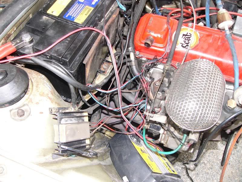

More gremlins sorted. Got the oil pressure switch working and cleaned up a heap of other wiring.
This is the main lead from the alternator to the battery. I guess someone had hacked an ammeter into circuit and later taken it out. This is what I found under the tape. Nice Huh?

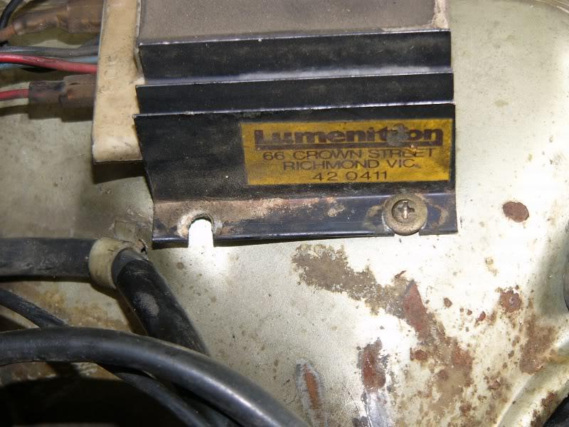

How old is this ignition module? 6 digit phone number?! Still works. It uses a photo interupter setup in the dizzy. - Old Skool!
Messy!

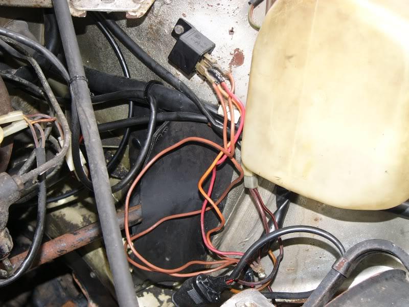

Fan relay wired by moron.
