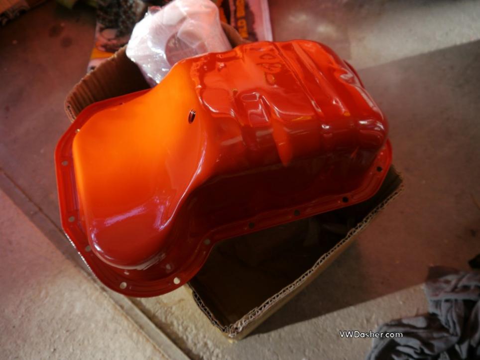

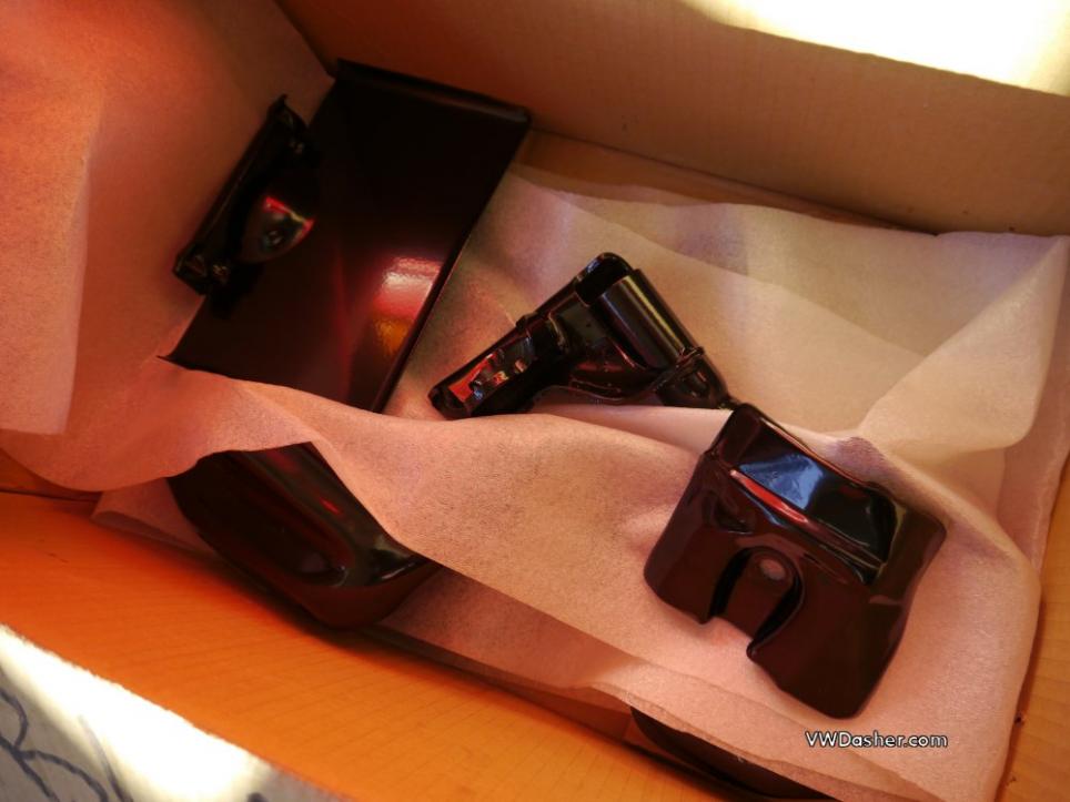

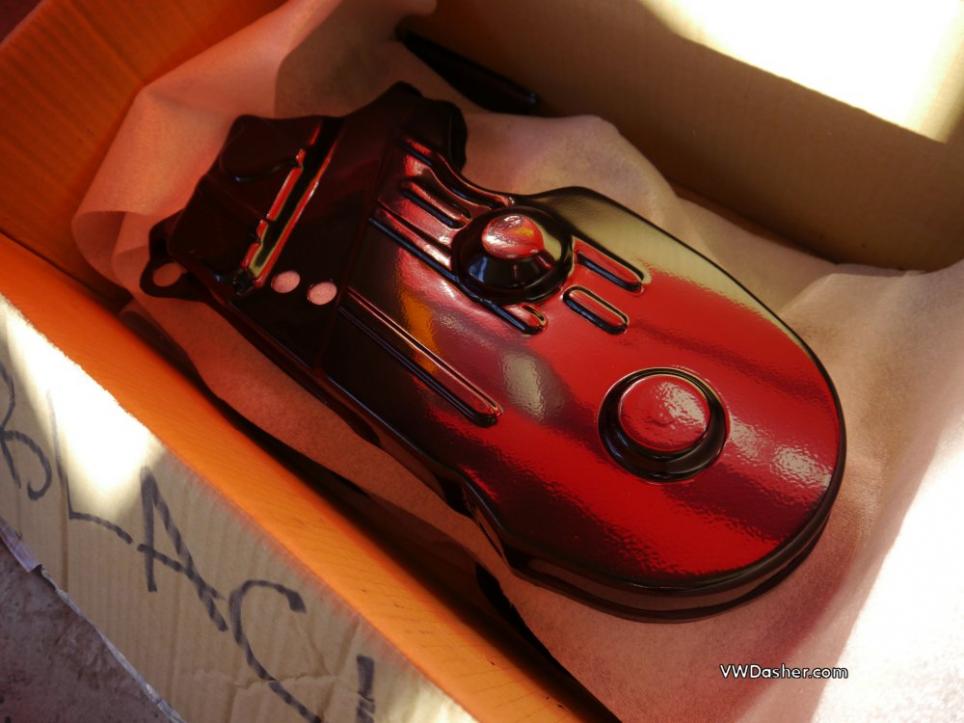

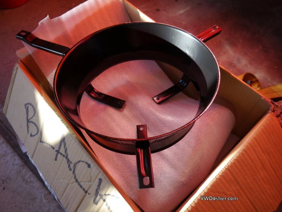

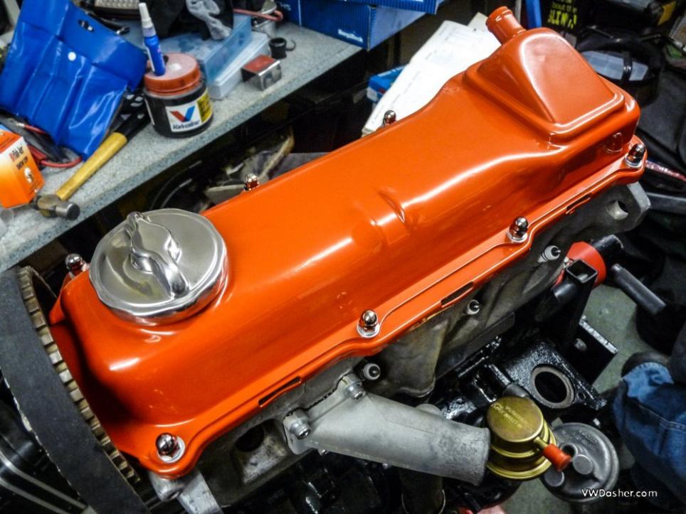

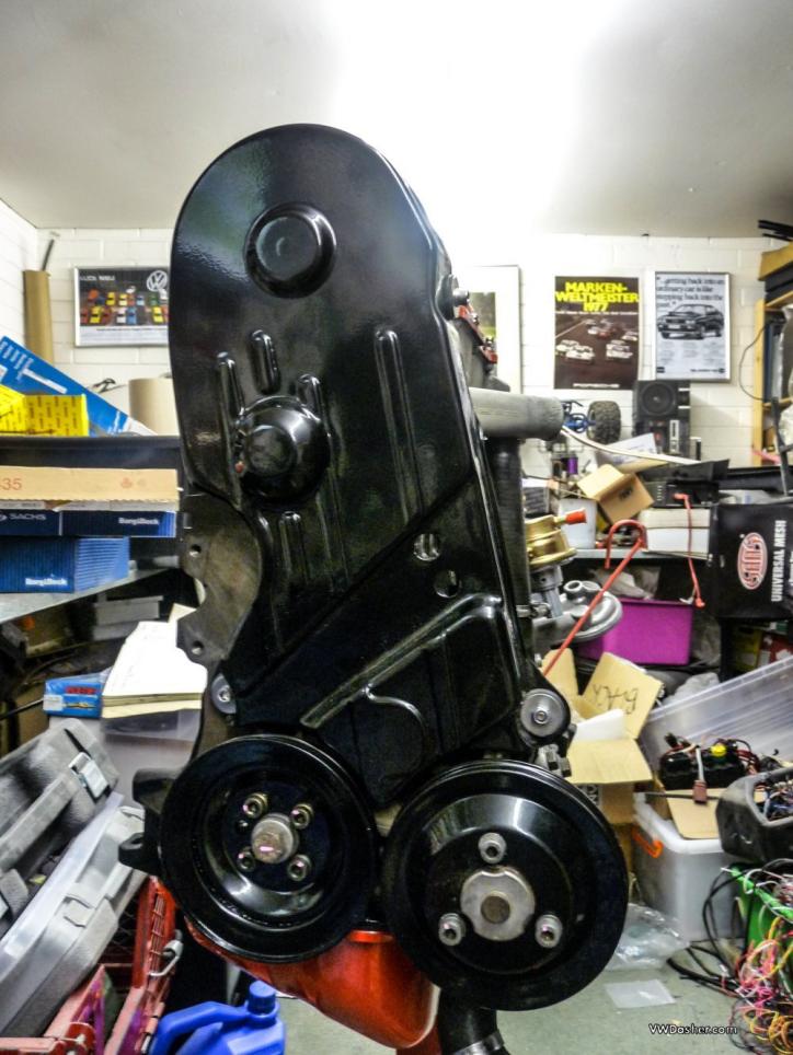

  • Just got a bunch of stuff back from powder coating.

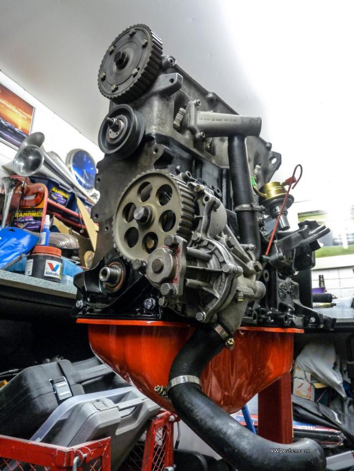

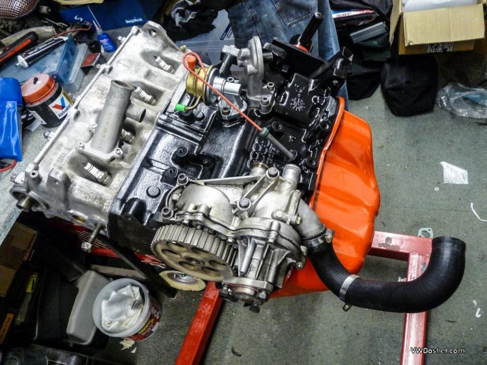

    • when are you starting the engine reassembly ?

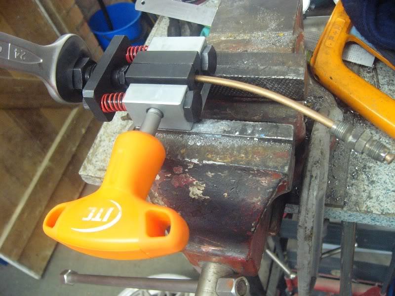

      • This is a really neat flaring tool I picked up from eBay, Awesome quality and a perfect flare every time.
        Hey Peter
        I love your work! Can I ask how much that brake flaring tool was and if you have a link to the shop on ebay?
        Thanks
        Martin

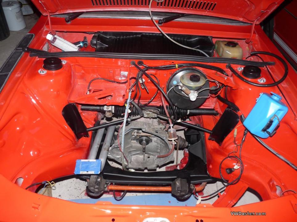

            • somethings different, but I can't quite tell what it is..... lol
              Great work Pete.

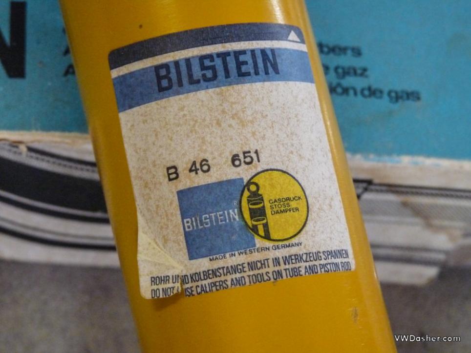

                        • Update from Jodie

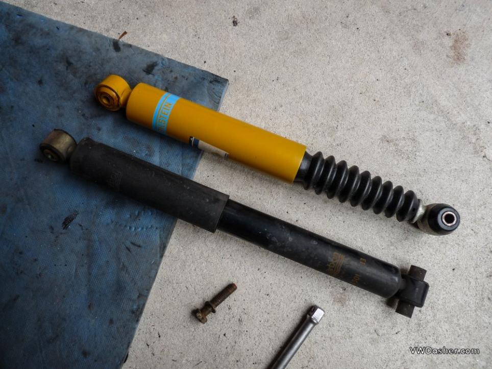

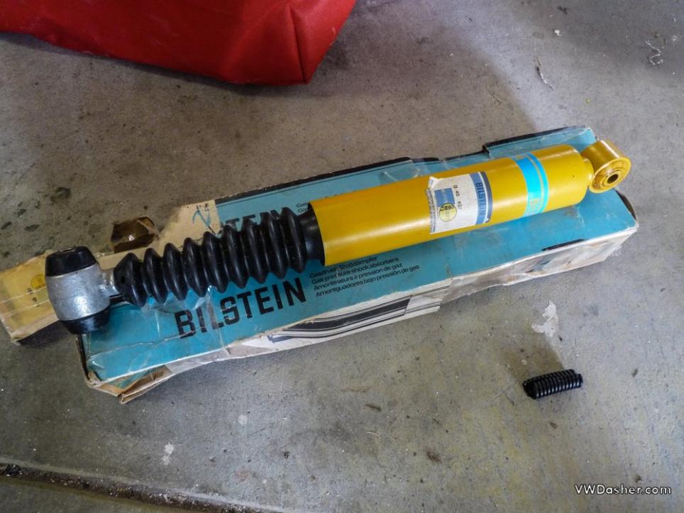

                          Picked up these on Ebay the other week, NOS Bilstein shocks for the rear. Listed as heavy duty, perhaps they were originally intended for variants? Who knows. Never been installed.
                          Made in Western Germany! Never used, just dusty and needed a few pumps to wake them up again.

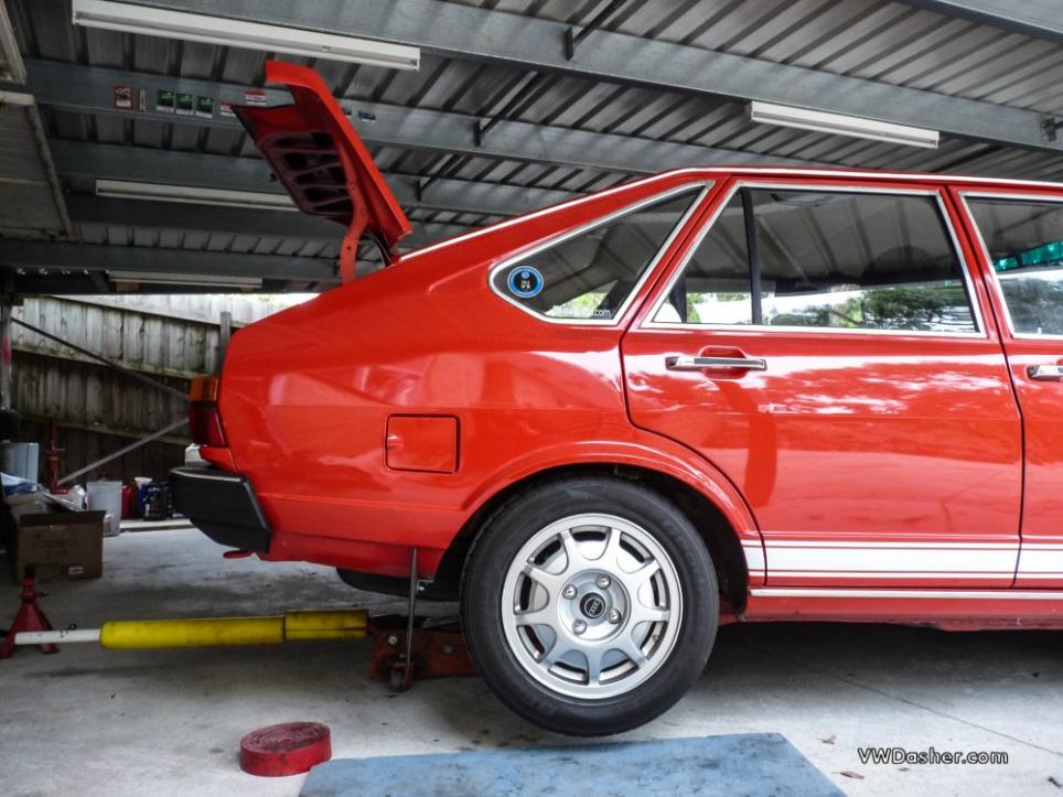

                          The fun thing about B1s is that you don't even have to remove the rear wheels to replace the shocks. Just raise, unscrew the top and bottom bolts and pull the shock out.
                          Old and new. The old ones are NOS De Carbon shocks I found on Ebay several years ago, one of those fluke finds when starting out with searching for bits for Frank, back when I was collecting parts to get him back on the road. They're still quite fine shocks, just softer than the Bilsteins.
                          Took Frank for a trip around the block with the Bilsteins in. Noticeably stiffer back end, you can come out of a corner more precisely now, no sideways roll or skitter. Really impressive difference. Now to see if I can stumble across some Koni's for Frank's front end....

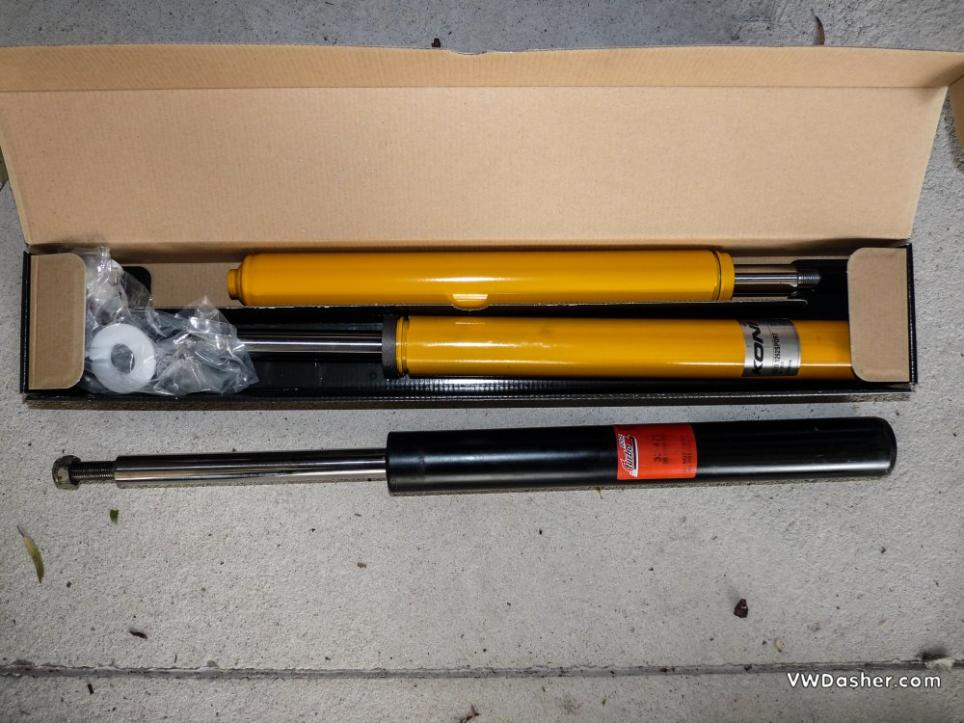

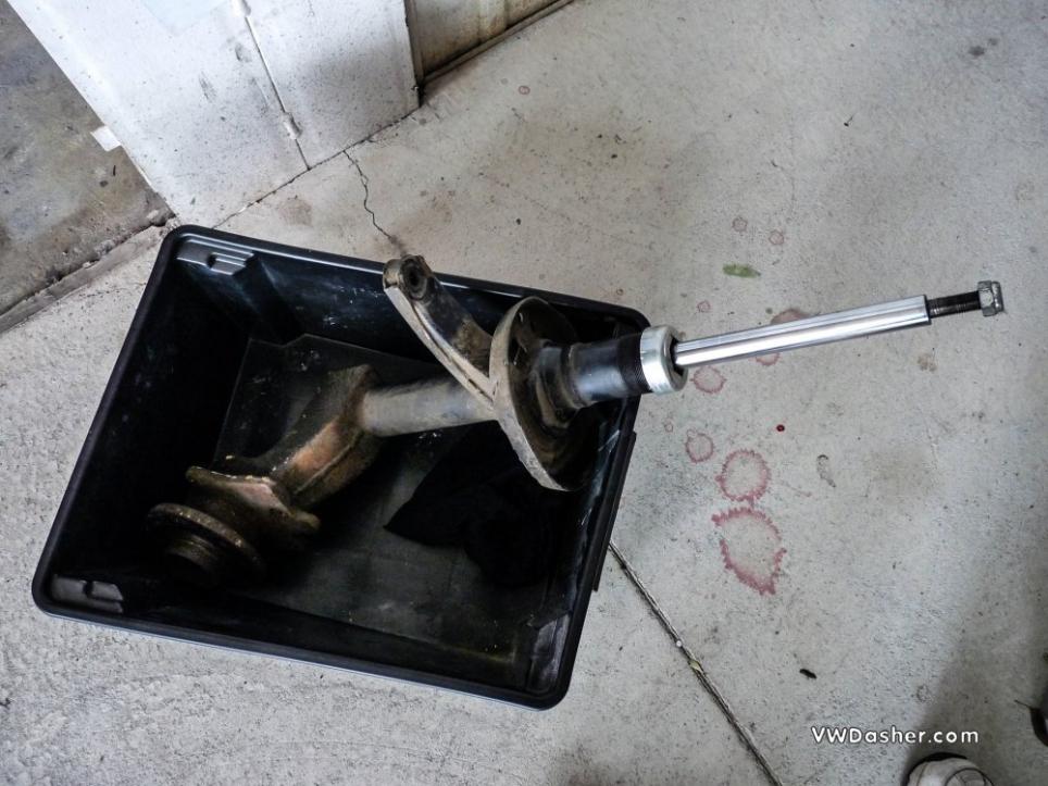

                            • Frank's going to get some new front shocks soon.
                              But first, clean up some front struts. Can't have those nice new Konis going into dirty old struts now can we?
