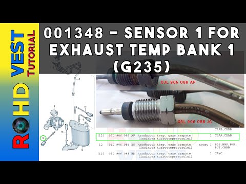

      This video (although its in Italian) gives you some good visuals of the issue if the sensor needs replacing.

                Hi , I own VW CC 2.0 Tdi ( 2014y) with 110.500 km till now . While driving I get the yellow error message same as is describe on the clip that Lucas_R post it. I went to my offical vw dealer and they told me that I have to change G235 ( black wire) immediately in order not to damge DPF filter. But from that moment till now ( 3 days) the yellow signs are not showing and eveything is working normaly. My question is it safe to wait till I get next error message than change it or I have to do it immiditely as they told me ?

                  Igor - it sounds like the VW dealership have probably deleted the error when they assessed your car which has taken the light off your dash. You might be lucky that it was a one-off type situation, but its likely that the error will come back over the next few days/weeks and you are going to have to replace the sensor.
                  Thankfully its relatively inexpensive and easy to change so you could do it yourself if you are handy, otherwise a small fee at your mechanic to fit it.
                  If you ignore it, you will likely end up with DPF (Diesel Particulate Filter) issues which is a MUCH more expensive problem to fix.
                    Lucas thank you for the precise response. Just as you wrote above, the error occurred and I have already replaced the sensor, now I have no problem.Thank you very much once again. All the best.
