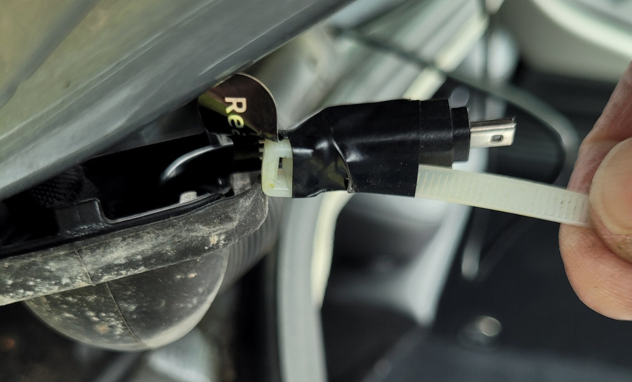

- Pull down the roof liner slightly, feed the cable in and then pull the cable out through the grommet opening. Then feed the cable through the rubber tube and pass through the boot lid. You may need a cable puller or similar for this.
