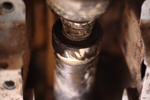

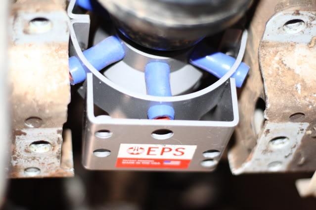

      Good bye drive shaft vibration. Hello Vertex.
      Originally posted by Preen59
      • #93
        I can't actually picture that on the car...
        • #94
          Driveshaft connecting the front transfer case to the rear differential.
          • #95
            Tell me you made that, otherwise I will be disappointed!
            (actually, I think it could have been purchased now looking at the complex bit on the back side)
            • #96
              It's one of those things bro , I could have made something but would have involved the car being out of action for a day or two , and it's a case of doing it once and sorting the problem.
              • #97

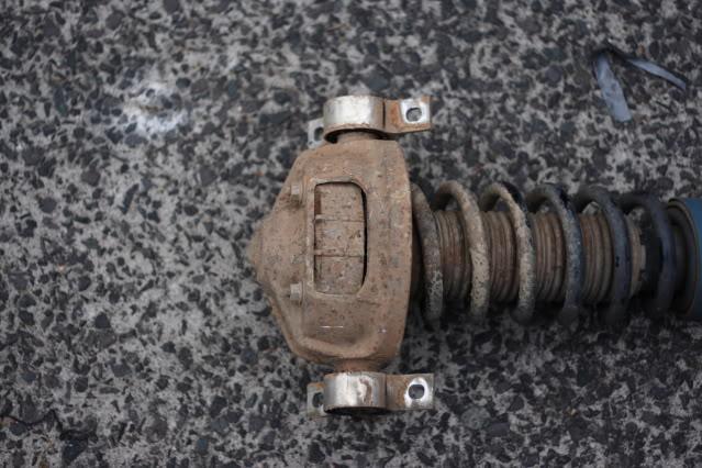

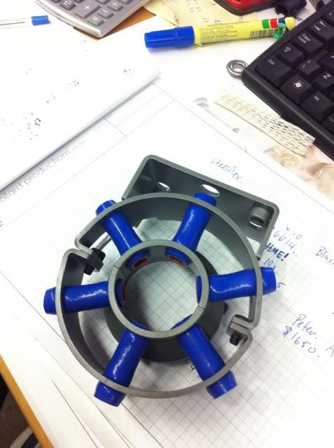

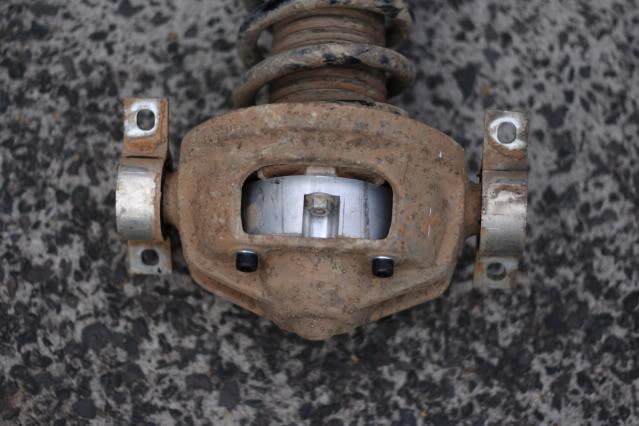

                Awesome kit, fitted it today in less than 1hr, and my baby is now oh so smooth.
                Vw take note.
                Out with the old.
                cut off to remove.
                bearing cleaned , rubber trimmed.
                Housed.
