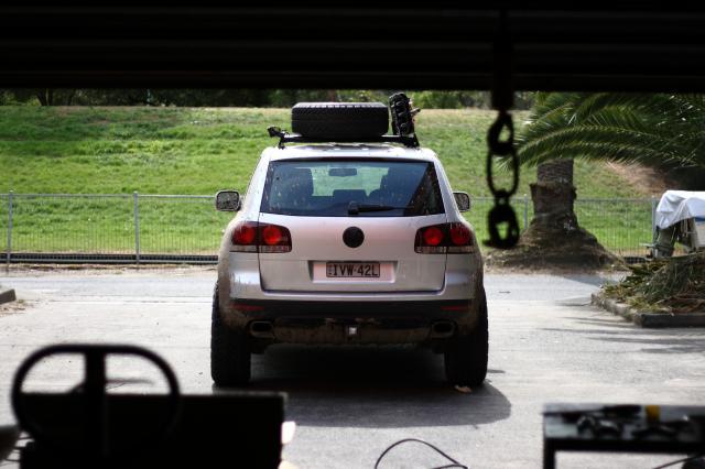

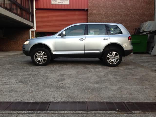

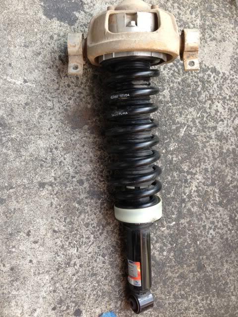

    I still have to fit the Seikel suspension I bought which I'm going to combine withe some spacers to give around 3" of lift. Currently I'm up about 2" and have had no problems with the drive shaft angles.
    It's gonna be close with the new setup.
    I have mocked it up and it's not to crazy.
    It should end up about 25mm above full height on air assist touareg but offer much more down travel and articulation than an aired system.

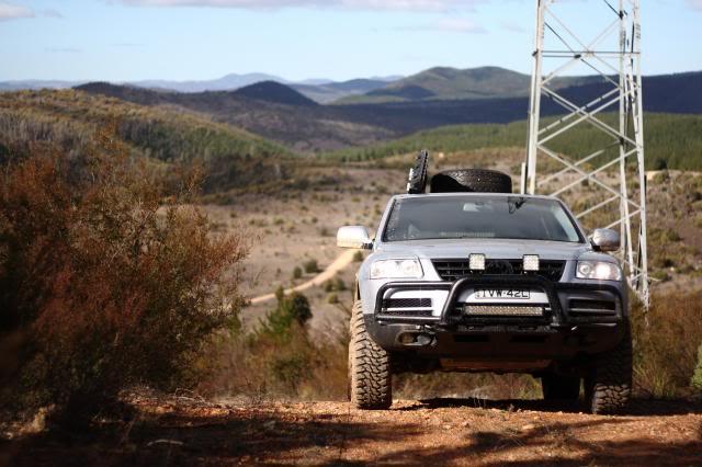

    • Latest outing in the Brindabella's
      Mt Coree 1370m
      Rear lifted again.
      Seikels in the house

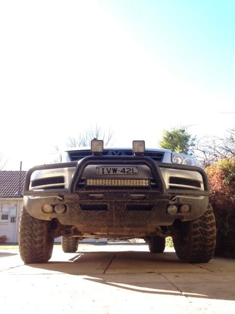

      Originally posted by Preen59
      • Looks tough.
        You won't even have to put it on a lift to check out the underbody soon!
        Love the LED lights.

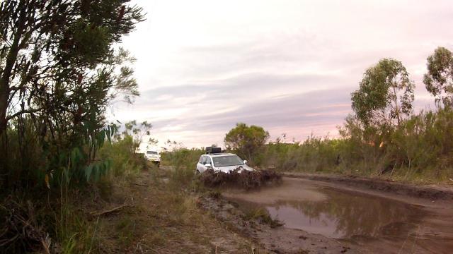

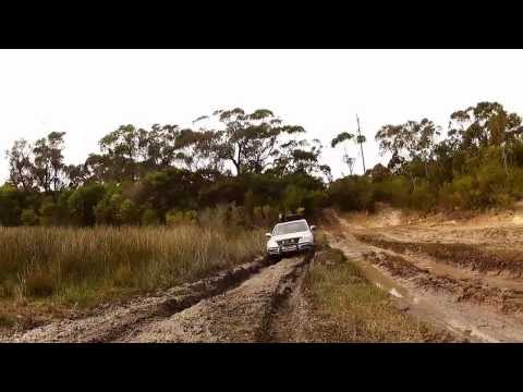

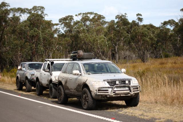

          Another outing , my bro has since sorted his hilux with lift and muddies we were also joined by a mate and his locked and lifted 80's series.
          Screen grabs from the last clips.
          • How'd does your t'reg compare to the 80, height and clearance wise?
            • So thats how it feels to be on top , got me a V8.
              The 80's got 35's so it has a bit more clearance but the treg was actually quite well matched to it.
              Really pointed out how well the treg's central locker and limited differentials work. The 80 has a Lokka rear diff locker fitted.
