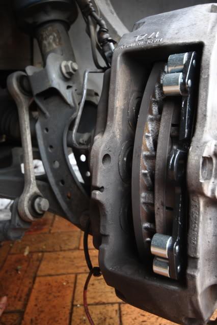

            Changed the front pads today, such a pleasure, nice to work on purpose built calipers. Don't understand why oem calipers haven't gone the pad from the outside route, really make changes a breeze.
            Big asss pads
            6 pots

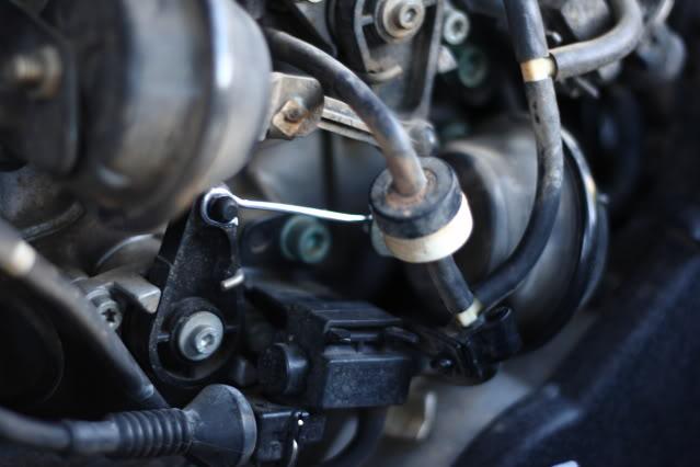

                  Have had a little hesitation at mid range, with a little looking about the manifold actuator arm had snapped, the lower one which aids mid range torque.
                  Had read about them going bad so I was straight to them for inspection.
                  Bodged up an arm to get me by and the car feels free of the little flatness.
                  I have some gruven arms on the way, In hindsight could have just lived with the bent up Tig rod but worth doing worth doing correctly.

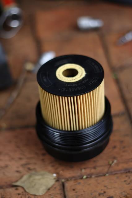

                              9 litres of oil you say, holy flood gates.
