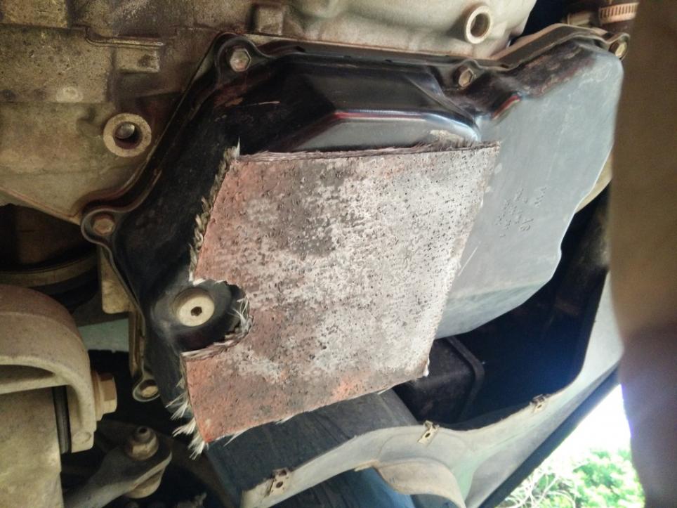

And just climbing under the vehicle there appear to be 2 "plugs" you can remove to drop oil, and although I am pretty sure that the engine oil sump plug is the 19mm bolt at the mid rear of the engine I thought it best to just confirm that.
The 5mm hex-tool bolt on the bottom of the flat pan on the left side of the engine underside is for the gearbox oil, right?
