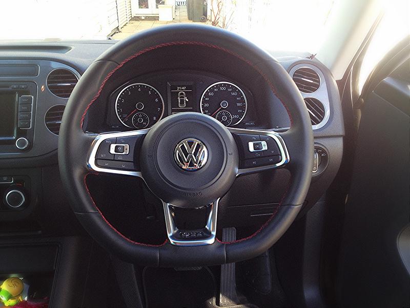

        First update for a little while. Mk7 GTI steering wheel has just been purchased and will get fitted shortly in the next couple of weeks.

              Well the physical installation of the Mk7 wheel wasn't too hard. There was the small issue of having a spare spade connector - essentially another earth connection, however nothing to connect it to so I ended up taping it up and leaving it unconnected.
              The good part is that the horn works. The bad part is that all the buttons are screwed up (and many don't work at all). OK button is volume down and I can select the channel up down with the other inside selector buttons but all the other buttons don't work. I'm looking to get my hands on a vagcom cable (was going to need this for coding the DSG paddle shifters anyway) but looks like its going to be a few changes required in terms of coding and possibly even wiring to get everything sorted...

                        Well I've got the paddle shifters working but haven't been able to sort out the other buttons. It doesn't look like there's an option in VCDS to select cruise control on the steering wheel... at least not with my SWCM.

                          • #58
                            Thought I'd at least post a picture of the steering wheel... although it's not working 100% at the moment I'm hoping to have that sorted out shortly.
