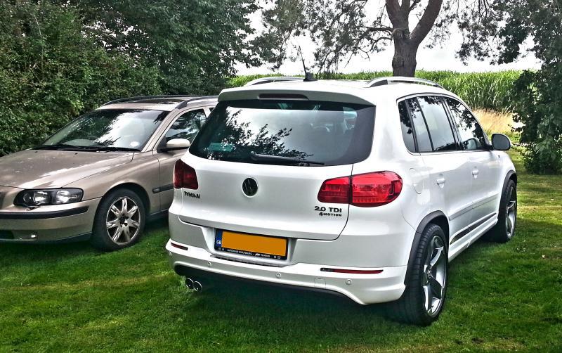

Hi I haven't installed them yet but just trial fitted to see if they caused any bulb out errors and they didn't. To get around the fog light problem I consulted with baboo and his comments were useful. Both the inner lights have allocation for a fog light holder to be installed. The lights come as LHD form with the fog on the left......BUT.........the hole is simply blocked off on the right so all you need to do is drill a hole large enough to get the holder through and then swap over the bulb holder from the other side.
That's my first step. Once installed I will eventually buy another fog holder light holder from VW and wire it up to the other side, either direct or via a relay as a friend advised it will put less strain on the BCM.
As for the lights, yes I got them from the same place as baboo. They sent me the wrong set first with halogen turn signals but then sent out the right version which is all LED, so I have the other version for sale as they don't seem bothered about me sending it back.
I will post up my pictures once fitted and try to get some good shots showing how they look at night/dusk as LED's always come out too bright in photographs.
