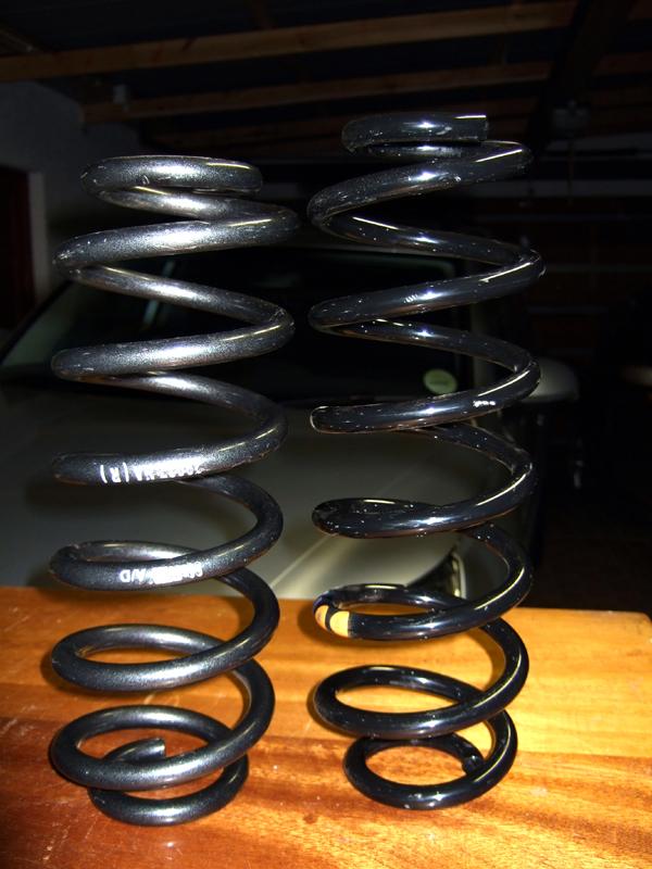

                If you look at the myTiguan forums, there's a guy there (jjj) from South Africa that has done a lot of the groudwork regarding suspension. Take a look at this thread: H&R Lift springs - myTiguan Forum
                Summary of H&R Lift srpings is:
                - The product advert claims 30/15mm lift front/rear. On jjj's 2.0 Tdi it could only get 21mm in front and 3mm LR and 7mm RR.
                - The suspension raise is achieved by increasing the spring rates. i.e., the H&R rear springs are actually 20mm shorter than the original ones but still lifts the car. In other words, the car will have raised sport suspension.
                After trying the H&R's he made his own strut spacers which I was very interested in trying. On the advice of my father I did not end up going for them while my Tig is still under warranty though. The prototype spacers he made gave 30mm lift on the front, but he reckons you should not look to do much more than 25mm lift otherwise it affects your camber. I can give you his details if you'd like him to make up a set of spacers for you. He does illustrated instructions and all.
                Check out this thread where I've asked the VWWatercooled community for their opinions on other alternatives: http://www.vwwatercooled.org.au/f39/...ves-43385.html
