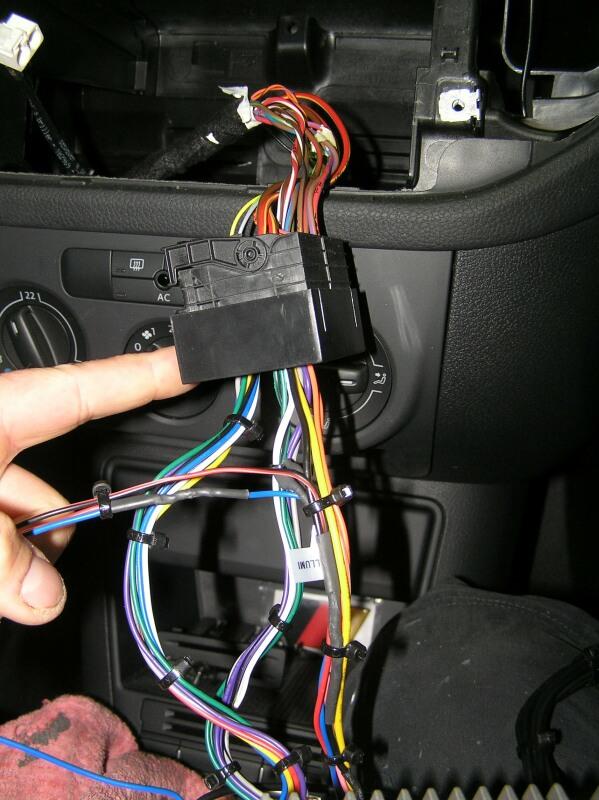

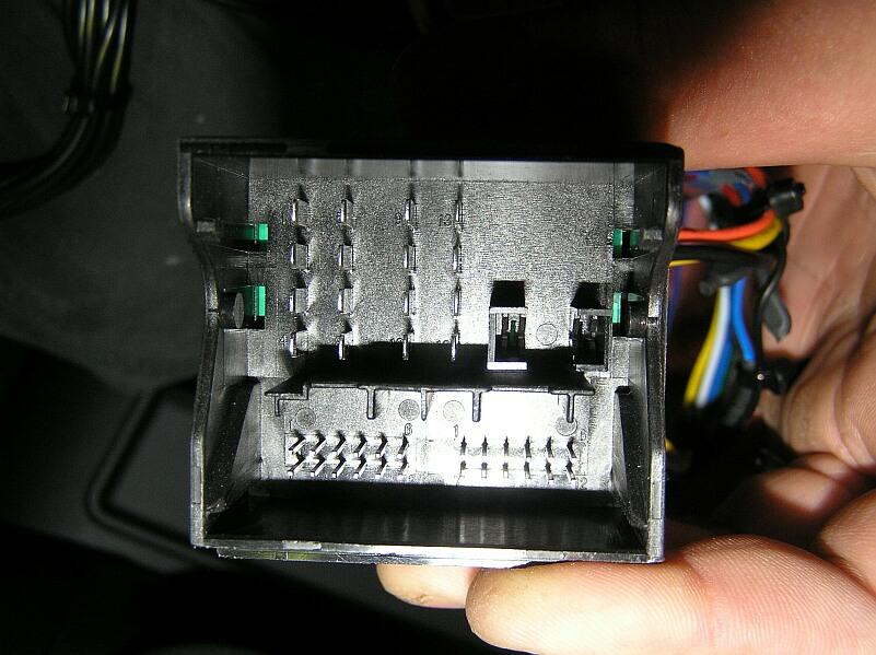

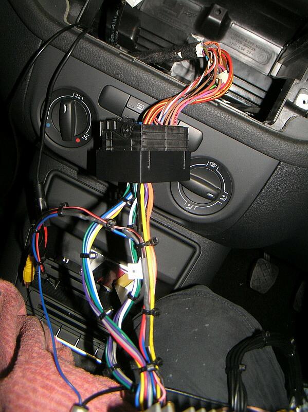

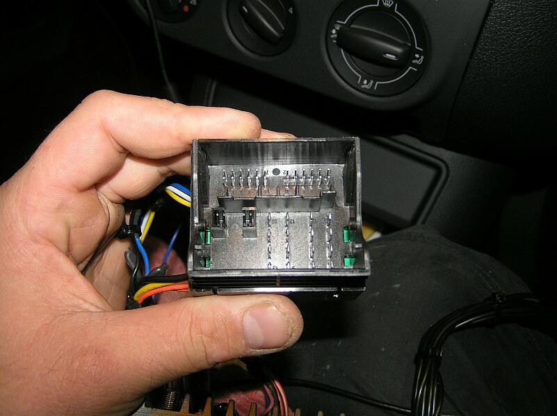

            On another note; you'll appreciate from the images below that there are only two loom plugs that interface with the car itself - the main loom plug and the aerial plug. Both of these plugs possess specific shapes and lock clamps making installation of them upside down or backwards impossible. In other words; it's going to somewhat difficult for any installer to get this wiring wrong - period. You'll also notice all the pins are straight and are not bent in any way shape or form.
            So I'll thank you in advance for not insinuating that our workmanship is the cause of the issues at hand here. To everybody else; we have another deck here now which we are going to try. Either Vincent or I will keep you informed of our findings.
