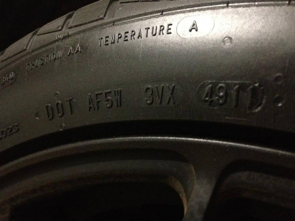

I'll go have a look at the DOT later. Haha WTH is 'shooting blanks'.. I wldnt have asked if u didn't bring it up Matt haha
Tyres - what did you get?
Here is how you interpret the DOT Tire Identification Number in full:Originally posted by aussietig View PostYes fellas ... DOT is the 4 digit number on the sidewall that gives away the production date (i.e. age) of the tyre.
DOT AABB CCCC DDDD
DOT: United States Department of Transportation
A: Manufactuer's Identification Mark (typically denoting the factory and its location)
B: Tire Size
C: Tire Type Code (Optional)
D: Date of Manufacture

Back to my original question, do all your tyres have the same DOT (which we've now established as 4911)?Originally posted by HaywireTig View PostYup that's wat I meant. Thanks!
Ideally for people like me with an OCD, you'd want all your corners to be the same and therefore from the same batch.
