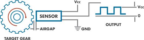

    The general set-up for a Hall effect sensor is like this (I thieved the picture from the web) :
    As you can see- these senors use an external power supply (labelled "Vcc" in my diagram). In your engine, this power-supply is 5Volts - which is generated by the ECU. There is also a ground pin for the 5Volts which is different to car earth and the remaining pin is the pulsed voltage that is the speed signal to the ECU.
    I'm not sure about this particular G28 sensor - but normally on these 3 x pin connectors:
    • 5 Volts = pin #1
    • Signal = pin #2
    • Earth = pin #3
    The best way to check the operation of this sensor is with an oscilloscope because it will show how the voltages change with time - but it's unlikely that you will have access to a scope. There are a number of You-tube videos that describe how to use a multi-meter to check the operation of Hall-effect sensors
    So - the way to check the wiring for this sensor is to grab a multi-meter and first measure if the +5Volt power supply is present at the 3 x pin sensor connector. It's unlikely that the +5Volt supply from the ECU is faulty because this same power supply is used for other Hall-effect sensors on the engine -but it may be absent at the connector on this particular sensor.
    The other possible reason for this fault could be the condition of the air-gap between the sensor and the toothed wheel. Shine a torch onto the gap and check that it's clean and free from detritus.

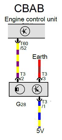

                  @Peedee61:
                  Here's the pin-out and wiring diagram for G28 on the Tiggy ECU for a CBAB engine:
                  If you aren't familiar with VW nomenclature - T60 /52 means pin #52 on the ECU connector that has a total of 60 x pins.

                    Hi DV52 I have traced the wiring from the sensor pin 1 in the connector has 5 volt power which is in the engine bay wiring harness, pin 3 has a continuous earth when measured with a multi meter and pin 2 the sensor wire has continuity to plug 60 at pin 54 ,the sensor wire goes to the 60 pin plug at the ecu and joins pin 52.
                      • pin 1 in the connector has 5 volt power which is in the engine bay wiring harness,
                      • pin 3 has a continuous earth when measured with a multi meter and
                      • pin 2 the sensor wire has continuity to plug 60 at pin 54 ,the sensor wire goes to the 60 pin plug at the ecu and joins pin 52.
                      I've changed the structure of your sentence above so that I can better understand your words.
                      I understand your pin #1 and pin #3 test - good results!!
                      But I don't understand your pin #2 result - how can pin #2 have "continuity to plug 60 at pin 54" AND the wire also "join pin 52" ?
                      On my Tiggy wiring diagram for the 2.0 ltr Diesel CBAB engine (from May 2010) - T60 /54 (i.e. pin #54 on the 60 x pin plug) is connected to one of the pins on the Coolant temperature sender G62 (which is a 2 x pin temperature variable resistor).
                      Again, my wiring diagrams for this engine say that the wiring for G28 is entirely independent to G62!! So - there should be no connection between pin #54 and pin #52 on the 60 x pin ECU plug

                        Yes I mucked that up in that pin 52 on the 60 pin ecu plug is the signal wire from the G28 crankshaft sensor, and meant to write pin 53 on the 60 pin plug is the earth for a large number of sensors and yes pin 54 is for a 2 pin temperature sensor, I have notes written on a book here but I have numbers and terminal numbers for different sensors all over the page, with lines trying to join them up and make sense of what I need to look at.

                          @Peedee61: Arrhhh.......... that's much better -now I understand your pin-out description (and your latest words agree with my reading of the CBAB wiring diagram).
