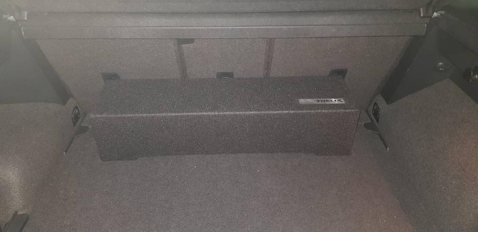

          Bumping this - ditched my previous setup posted earlier in the thread and installed the Helix 'Plug and Play' sound system upgrade. I grabbed the subwoofer box version rather than the spare tyre version.
          Way better! Should have done this in the first place rather than mucking around with the underseat sub and amp. Install was very easy, I spent most of my time undoing my previous install wiring.

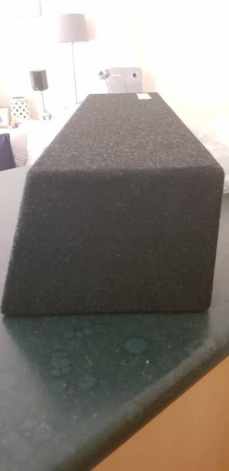

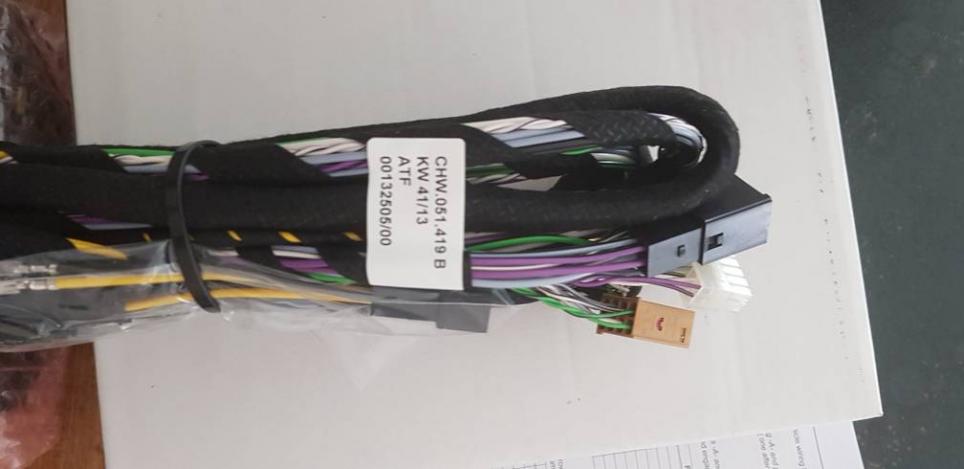

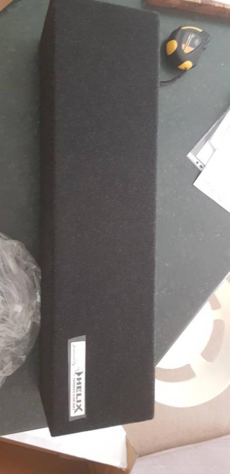

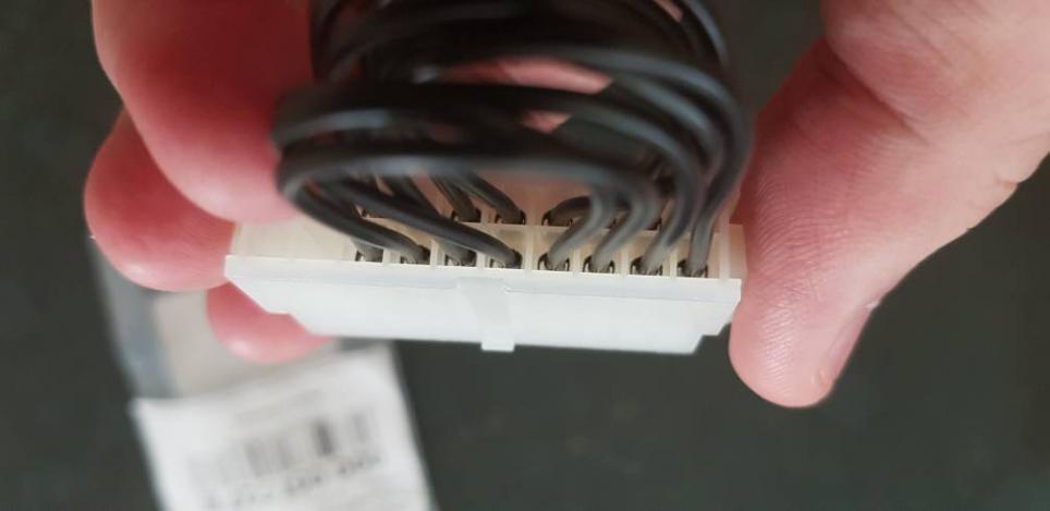

              Sure - there's not that much to look at! Excuse the quality of the 'installed' pic.

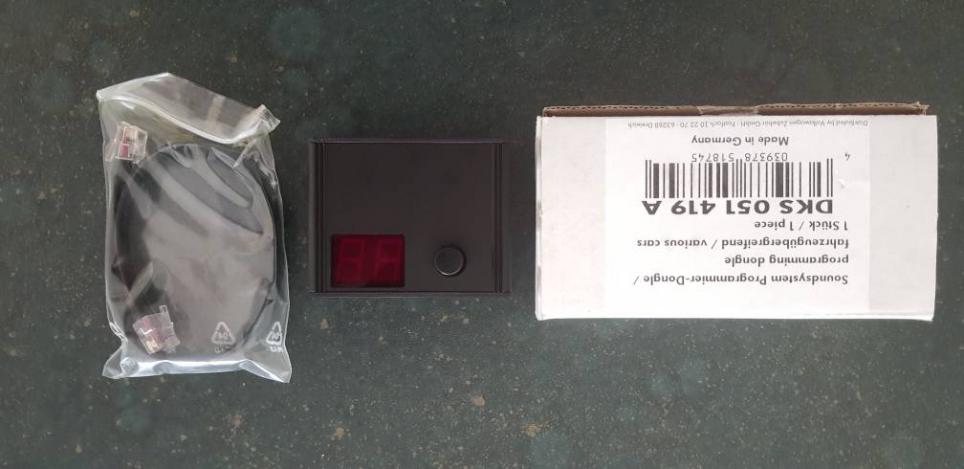

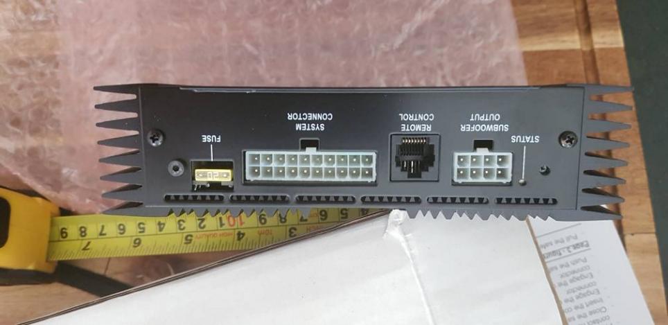

              Look up part number 000051419A or C. Made by Audiotec-Fischer in Germany, uses 2 of their 6.5" Helix woofers and an unlabelled Amplifier/Digital Signal Processing unit which is a variant of their Match PP50/52 DSP. Comes with VW compatible wiring loom which runs from the head unit, a bit of trim removal and head unit removal is involved to fit it and run the loom through the car, and some moving around blocks in the head unit quadlock plug and the power pins.
              Plenty of YouTube videos and written install guides out there. Only took me an hour to do once I got rid of my previous install wiring.
              Part A is in stock in Australia, C is a later build run and would have to come from Germany. No physical or functional difference between the two parts, VW Australia will sell you the A revision.
              If you need the space to carry stuff, you can unplug it and plug the included 'loop back' plug onto the end of the plug that goes into the Amp/DSP and you have your factory sound again.

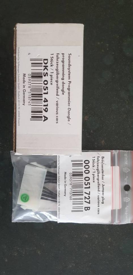

              The DSP profiles need to be programmed using a separate little unit, can see that in the attached pics
              000051419 and the B version are spare tyre cavity mounted. If you have 4 Motion, there's not enough room under the floor for it and the spare tyre, hence the rectangular sub box. You could ditch your spare and just use a repair kit but it would be just your luck that as soon as you remove the spare you'll need it!
              In summary:
              - Part no. 000051419A is the sub box, amp and wiring loom. Includes the loop back plug in it. Will be called "Sound/Speaker Upgrade Kit". RRP $775 from all Aussie VW dealers.
              - Part no. DKS051419A is the Programmer for the DSP fields. Will be called "Soundpaket". This is needed to code the Amp/DSP with the sound processing profile for your car, in our case profile 20 for the MK2 Tiguan. RRP $174. Other countries have people who lend/rent these out as you only need it for about 2 mins. Dealer is unlikely to have one of these so simpler just to buy one.
