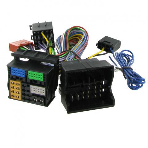

                        In other news, there's a 20% off sale on certain eBay stores - because I don't want to chop up the harness on my Tiguan I'm going to order this:
                        Aerpro Volkswagen Golf Mk7 2013 On T Harness 5055193348106 | eBay
                        Sale starts at 10AM, use code PERFORM20
                        Pretty much this harness is designed for people adding on additional stuff to their car (fingers crossed it works on the Infotainment). Based on frostywinter's install (Golf R MK7.5) he used the following diagram to tap into the speakers via plug N
                        Slowly have been acquiring the parts, just need the WX610A now - waiting for an eBay sitewide sale!

                                The Pioneer TS-WX610A is all installed, very happy with the result. Nice boost to the stock system, has got some real kick now.
                                The T-Harness whilst tricky to all fit in did the job nicely, was able to tuck in the extra cable/connectors in the space directly above the head unit. Accessories power came from a fuse just like Dan mentioned. Decided on pulling power from the battery through the firewall via a spare grommet, same location as the one on a Mk7 golf - https://www.autoinstruct.com.au/manufacturer/volkswagen/mk7-golf/running-cables-through-the-firewall/ once I found where it came through in the passenger foot well, was relatively straight forward pulling it through (it ended up sitting behind a big bundle of wires).
                                There is plenty of room for running the cables under the floor trim, started by removing this in the rear passenger seat and then moving forward to the front of the car. Removing the floor LED light connector was straight forward, was a decent connector/wire not a ribbon as some earlier models.
                                All in all, was not super difficult, just took quite a while as I really took my time and did a fair bit of research looking at Mk7 Golfs for hints along the way.
