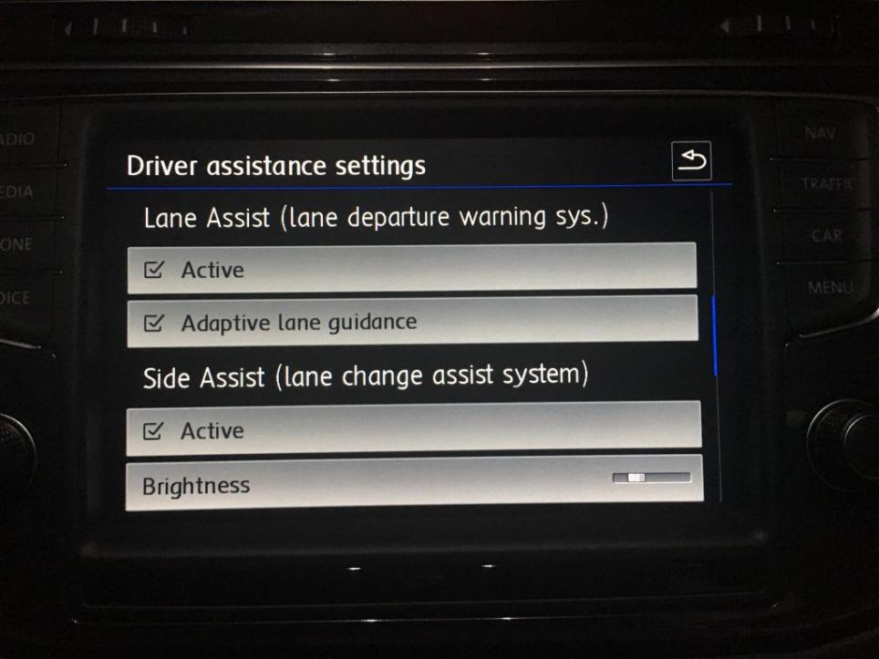

Hi peanut, do you mind letting me know how you coded the Adaptive Lane Guidance? I have changed the "Point_of_intervention" to "Early (settings via menu)" in module A5 but this doesn't seem to have fully worked. I now have the option to toggle Adaptive lane guidance in the Driver assistance setting in the Infotainment unit but I don't have the option for the Waring level:
I am assuming there must be something extra that needs enabling that I have missed? Even though it is showing as turned on it doesn't appear to be working as the lane assistance still doesn't kick in until I get over ~65km/h and still pinballing in the lane.
Also interested to know how you enabled Light Assist as well as I will like to try turning this on in my car as well.

Originally posted by NZ_GolfR View PostI am assuming there must be something extra that needs enabling that I have missed? Even though it is showing as turned on it doesn't appear to be working as the lane assistance still doesn't kick in until I get over ~65km/h and still pinballing in the lane.
I will hopefully have a copy of all the module backups later today so will PM them to you as well.
