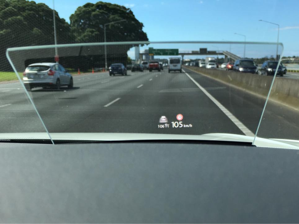

      Just to give an update the coding for the Dynamic Road Sign Display works on NZ version of the Tiguan R Line (forgot to mention earlier that I didn't need to change Byte 24, Bit 6 in Module 5F as it was already activated).
      The only issue is that I don't get the road signs showing in the Heads Up Display, I do get the warning there if I go over the set speed limit though. I noticed that if I go into the Heads Up Display setting in the Car Setup screen there is no option to turn this on or off like the other features so I am guessing there is additional coding need to enable this. When I get a chance I will have a look at the modules and see what other adaptations there are to see if I can find this one to enable it.

        Oh yes, I forgot to include the instructions for enabling traffic signs on HUD because such spec doesn't exist in Australia.
        I will dig around to see how it can be enabled.
        EDIT: Try this, I compared coding with someone else. No guarantees that it will work because I haven't tried it.
        Module 82
        Coding
        Long Coding
        Byte 0, Activate Bit 0.
            Module 82
            Coding
            Long Coding

                          Yes, can confirm that did work and I can now toggle this on and off in the Heads Up Display settings in the Car Setup menu. Looks pretty cool:
                          I don't have a VCDS scan of the car as using OBDEleven dongle but I take a backup of each module before I modified it so can send you some or all of these if that would help.
