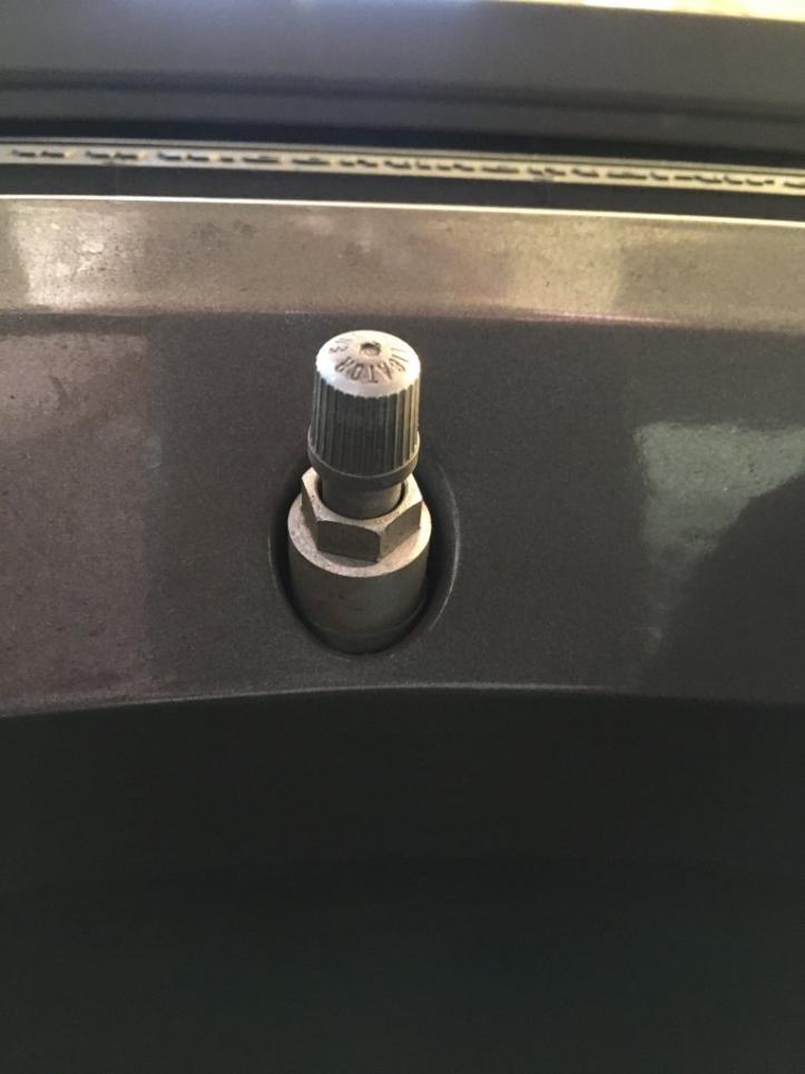

    About car tyre pressure system. My car does not appear any thing for each tyres. They just showed the "" SET "" detect any loss in each tyres. Is this usual or unusual for this kind of monitoring system ?
    Maybe yours has the Passive system like what was in my old MK6 Golf, it didn't have sensors in each tyre valve so didn't actually show you the tyre pressure for each wheel. Instead it uses the ABS wheel sensors to detect a difference in wheel rotation speed and therefore a loss in tyre pressure.
    Do you tyre valves look like this?

                • Definitely not a result of the OBDeleven mods. The Active Tyre Pressure monitoring requires special sensors in the tyre valves:

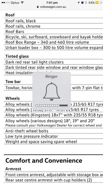

                  What does the Australia Spec sheet show for this?

                      Oz spec just shows low tyre pressure indicator only

                        Here is Aus spec's sheet.

                          • All of you are right, I checked and found that VW used normal cap to close on each tyres not the one showed by NZGOLF. We paid almost 60k for just intentive missing this passive system, how much does it cost just to cut it out?
