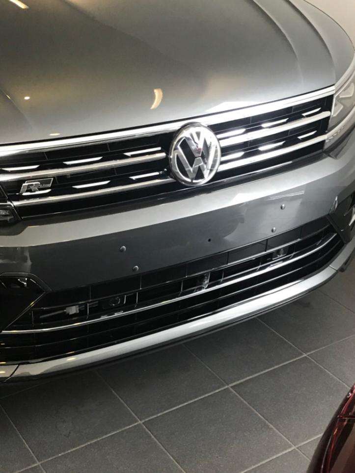

    So Australia Post managed to lose and then find my Bumper Plug package and so I now have them….however the holes are a fraction too big for the threaded part and the depth of the holes in the bumper only seems to be minimal, am I missing something?
    Currently I can pull them out again by finger nail so it seems that I may need to glue them or similar, any advice?

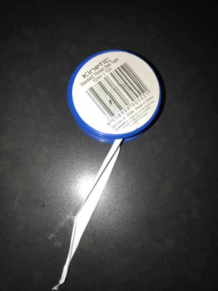

        So you have to build them up with some tape , l use some flange plumber tape so they fix firmly in hole and l use a same drop of super glue gel. Gel best cos it won’t run.

        • Teflon/thread seal tape would be good for the job
          Indium Grey Golf 7.5 Alltrack 135tdi Premium - all options
          • Originally posted by Rooboy View Post
            This is what l used.

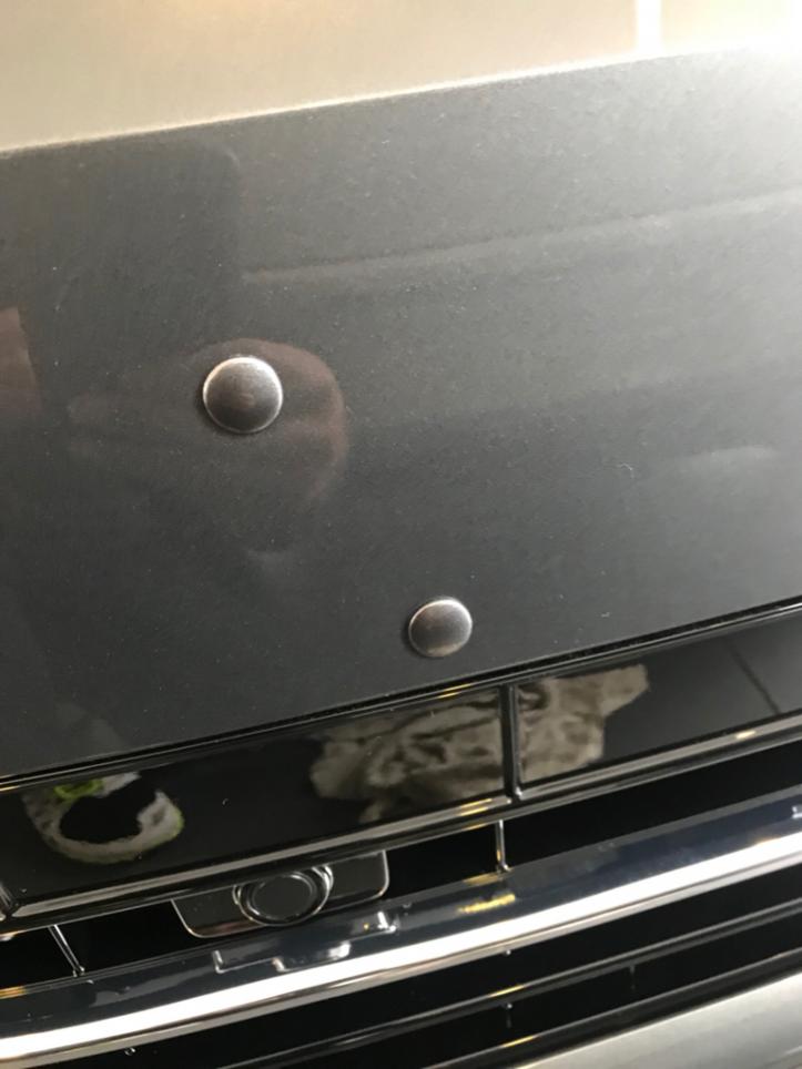

            • Do you hace pics of the installed product (and possibly the name or link?)
              Cheere
              • Originally posted by Pete8oes View Post
                Cheere
                You get the plugs from:
                BumperPlugs for Volkswagen
                Then l got backing plate and covers from kingpin, which u can buy from autobarn.
                MY18 Tiguan Highline 162TSI - DSG - Driver Assistance Package Sunroof- R-Line Package - Indium Grey. Oct Delivery
                • Thanks! Your ride looks great and the plugs look 'factory' (a good thing)

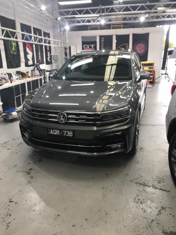

                    Had Pomponazzi xx paint protection and window tint done.
