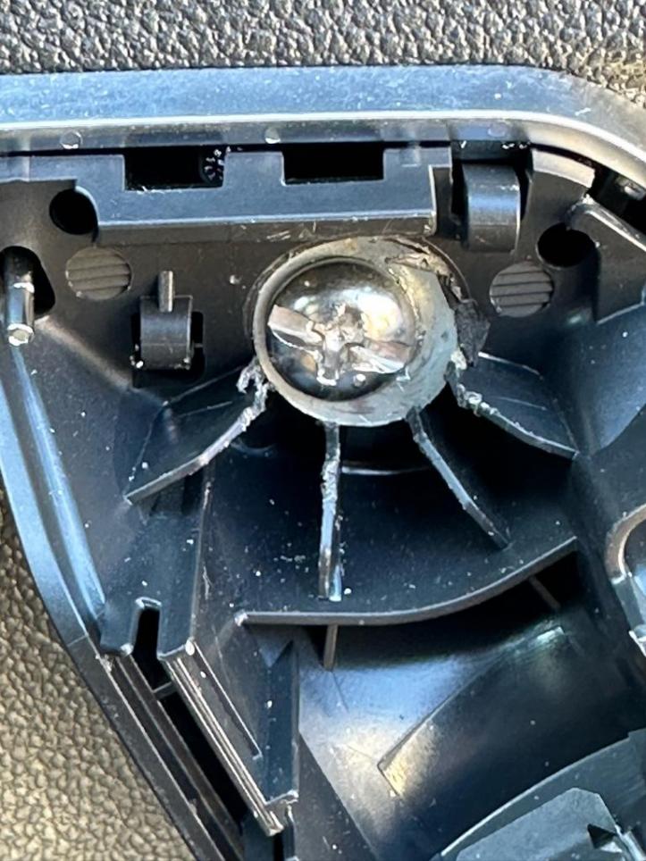

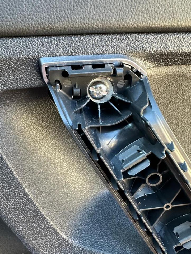

    The plastic has cracked where the screw holds the top of the interior door pull handle to the trim/door.
    Does anyone know how I can remove just the door pull handle (see picture which part I mean) or do I need to remove the entire trim?
    I really hope its not the whole door trim that needs replacing.
    Videos and instruction I have found all are for removing the entire trim, and the door pull handle seems to be attached so i cant see how they remove it for replacement.

    That close up photo suggests it might be a separate part and therefore replaceable. But you will have to likely remove the door trim to access it properly. You can see the part number in the photo 5NA 868 7xx (cant read the last 3 characters because its too dark). If you can get the full part number then you can order a replacement.

      Ended by doing a doggie DIY with a longer screw, a washer and some rubber.
      Jammed it in there. I thought as it's already broken - might as well give it a try.
      So far holding up

        Nice fix - no-one will see it, as long as it holds ok.
