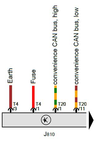

        If I look at my MQB wiring diagrams, I find that J810 is wired like this (my diagram shows the module from a CAN bus/power supply perspective only - of course there's lots of other connections on this module):
        I note that these pin-outs are different to @mig advice on post #9 - so something odd!! Anyhow, and at least on a MQB platform vehicle, the module gets it's comms messages from the Convenience CAN bus. Where did you hook-up the pins #1 & pin #11 on the 20x pin connector to the recipient car?

          Those pinouts were for the OBD connector side to hook directly to the module.

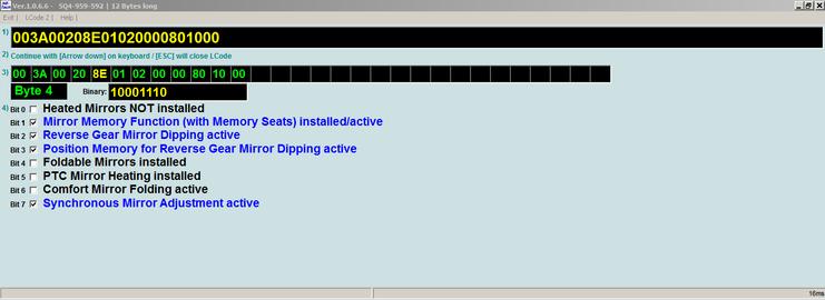

                I don't recall seeing anything about mirrors in the long coding Bytes, I'll have a look tomorrow when I connect to the seat module.

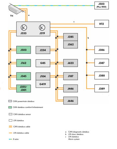

                    PS: Riddle me this, please - even if @MIG succeeds in communicating with this (these?) modules on his/her MQB test-bench and even if the initialization values are reestablished on the module (very, very unlikely IMO) - how does this outcome advance your project objective? This project appears to be one where a PQ25 based car needs to accept MQB equipment - it's NOT the other way around !!! What am I missing?
                    EDIT: maybe a picture is worth 1000 words - here's how the comms network is arranged on your Amarok (from SSP 463):
                    J533 is the Gateway module and J519 is the BCM in my diagram. Notice how these 2 x modules are shown as one box. Even though VCDS reports 2 x separate part numbers for these modules - I suspect on this car that these 2 x modules are physically one unit. My hunch is that VCDS formally separates the devices for the Gateway's diagnostic activities - but in truth J533 is simply a diagnostic interface chip with some allied circuitry that physically lives inside the BCM housing on this car. This is certainly NOT the case on MQB platform vehicles - both J533 and the BCM are functionally and physically completely separate units!
                    The other interesting observation about the diagram above is the positioning of J386 & J387 (the 2 x front door modules) on what VW calls the "LIN door databus". This arrangement confirms the way that these modules are reported in your SCAN - these modules are LIN slaves to the BCM master!! Given the simplicity of this arrangement, I wouldn't be surprised if J386 & J387 are nothing more than the motors for the fast-glass facility on your Amarok. Again, this is NOT the case on MQB platform vehicles - both J386 & J387 are fully registered CAN modules with much greater functionality!!
                    This car might be built on a B-VX62 platform, rather than PQ25 (i.e. this could be a 7N chassis vehicle - rather than 6N as identified in the SCAN report)?
                    And notice that there is NO j810 module shown in my diagram - suggesting that this car was never designed for electrically operated seats with memory function - a telling omission IMO .
                    Maybe a retrofit with MQB electrically operated seats (sans memory function) is a better choice for this vehicle-perhaps ?

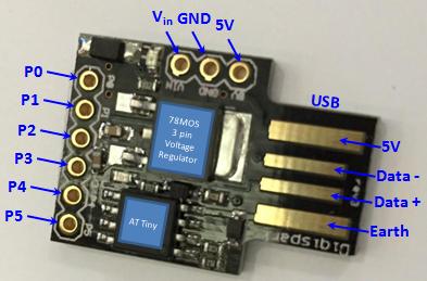

                        Respect!!! Good luck with the arduino solution! Maybe also consider using a Digispark PRO (see below) - it uses an AT-Tiny chip and it has the advantage of having an onboard 5V power supply (so very suitable for car-based projects)

                        • #42
                          @DV52 Sorry, I missed the picture of the Amarok network diagram, and yes, it is worth 1000 words, and you are 100% correct about the seats. The Amarok is not configured in a way I am used to seeing PQ platform cars; I mainly mess with Tiguans and Passats
                          With that information and the fact there was no factory standard Amarok seat with a memory option, your suggestion of the standalone MQB seat module would be the best. Any passenger seat module would meet that requirement as they don't have memory, correct?
