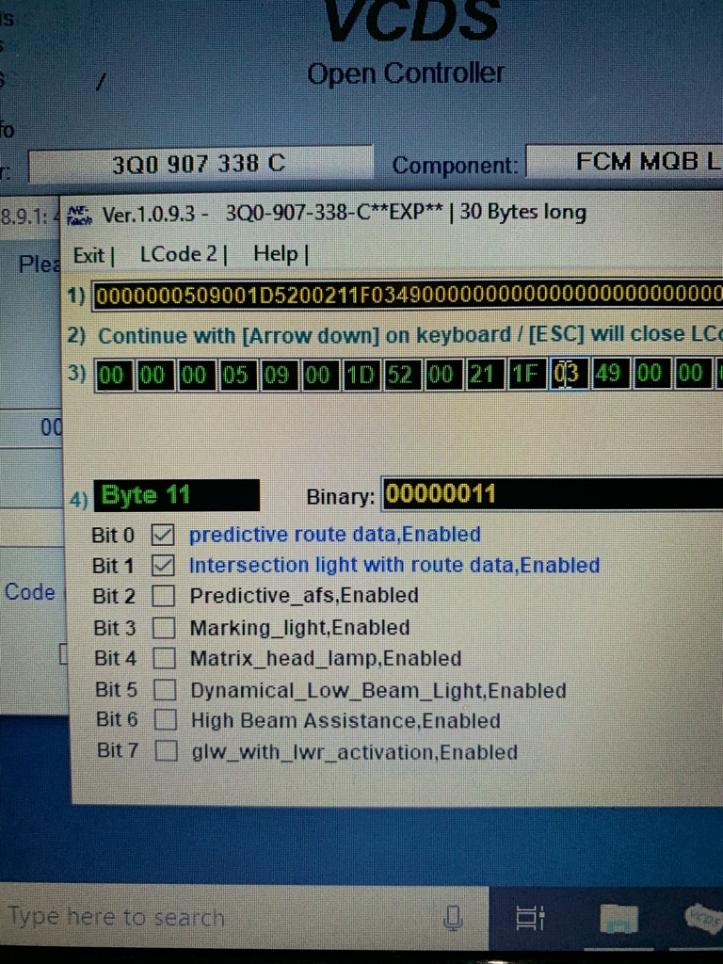

For those with the ROW model, was curious in 4B if the following were checked off and/or if someone can shed light on these features.
In Byte 11 what does dynamical low beam light enabled do?

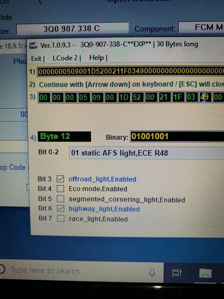

In Byte 12 what does segmented cornering light enabled do?

Originally posted by BinChook View PostNot sure if this has been covered previously, it's in regards to the highway/"country light" setting with DLA (see Audi's teminlogy).
Previously with DLA activated, I had the issue of the RHS lights always being on low beam at speeds above 80kmph, that is the "country light" pattern. Great if you are on the Hume, not so great when on a two lane B or C road in the country.
I've played with Module 4B as described in instructions in this thread and disabled Byte 10, Bit # for "Highway_light" via long coding. Counter-intuitively, I've now got the "motorway" beam pattern for all scenarios with the usual adaptive beam forming for masking traffic ahead or oncoming cars. Less useful on the Hume/split carriage-ways, but great for back roads.
my long coding for this mod in Module 4B is now "0000 00 05 01 00 08 56 07 10 57 05 0A" - this was implemented and tested in a MY18 SWB R-line with "mid" lights. No faults recorded
I did the whole head unit reboot, factory reset light settings and "basic setting" routine after making the change.
Hope that helps people if they find they have dipped RHS beams at speeds above 80kmph.
Ta
BinChook
[ATTACH=CONFIG]47143[/ATTACH]
I was testing last night, and sure enough, I did indeed have Highway light checked on under Byte 10, Bit 3. I un-checked the setting, saved, and still had the Country Light on. I checked it back on again to see if that would change, and nothing. Still country light. This setting does nothing for me.
I was under the impression that the "Highway Light" bit under 4B has nothing to do with DLA or high beams. From everything I've read, that setting simply makes your main beams raise a bit at highway speeds. If that is the case, I don't see what this would have to with the high beams or DLA. I'm thinking there may be another setting that I am missing somewhere and would love to find it and turn it off.
Thanks for your help!
