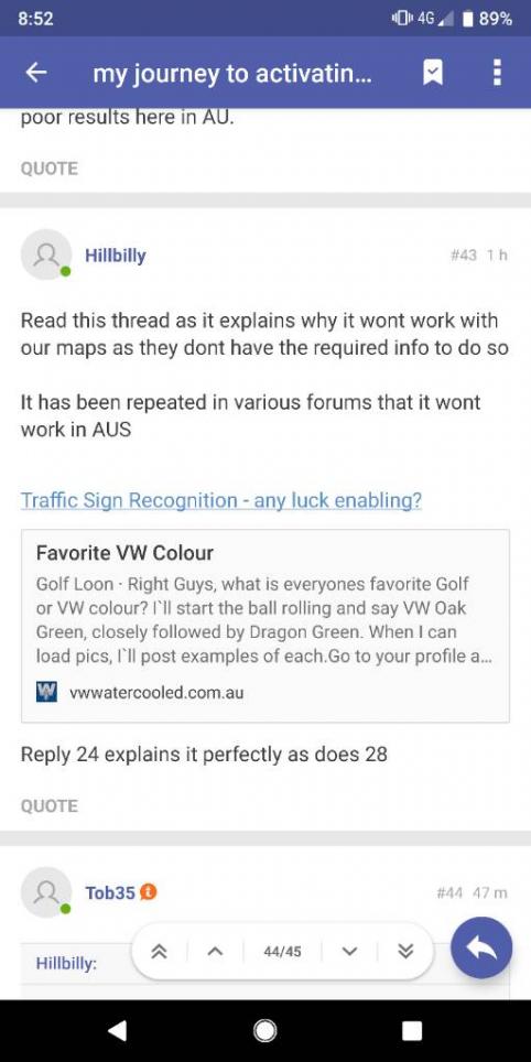

    What That thread is about getting information from maps etc and dont remember car colour coming into it
    Ive just re read the thread and nowhere are car colours mentioned
    So have no idea what you ar eon about
    The link is screwed. It's showing a car colour thread.

        Ahh.. I'm not that tech savvy. Don't even own a pc. Can you cut and paste the specific post?
        I found the thread it's about Traffic sign recognition? Is that the one? I can't see anye where it explains the predictive DRL from the GPS like mentioned by Phonebooth.
