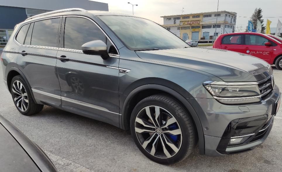

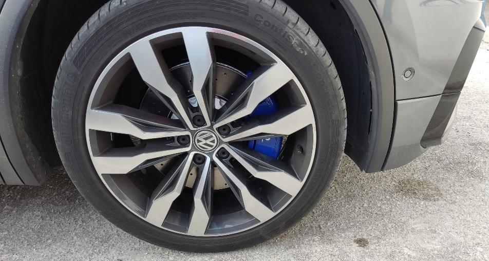

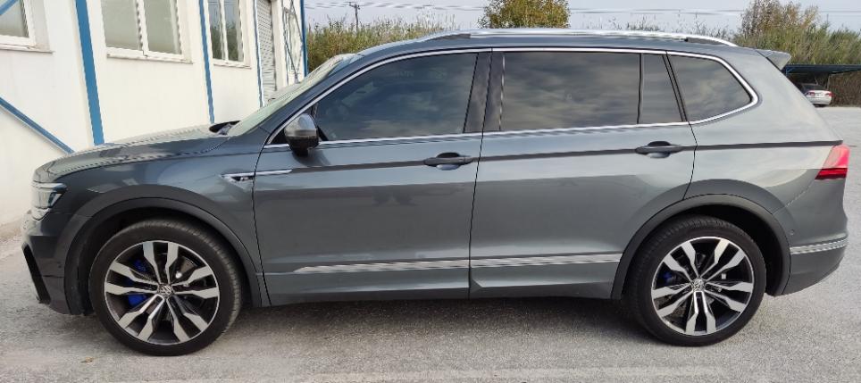

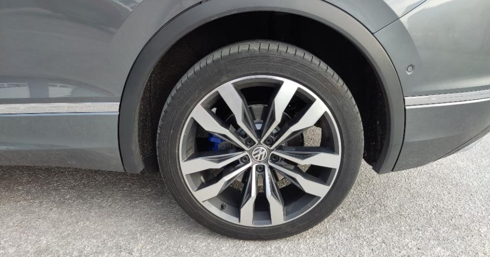

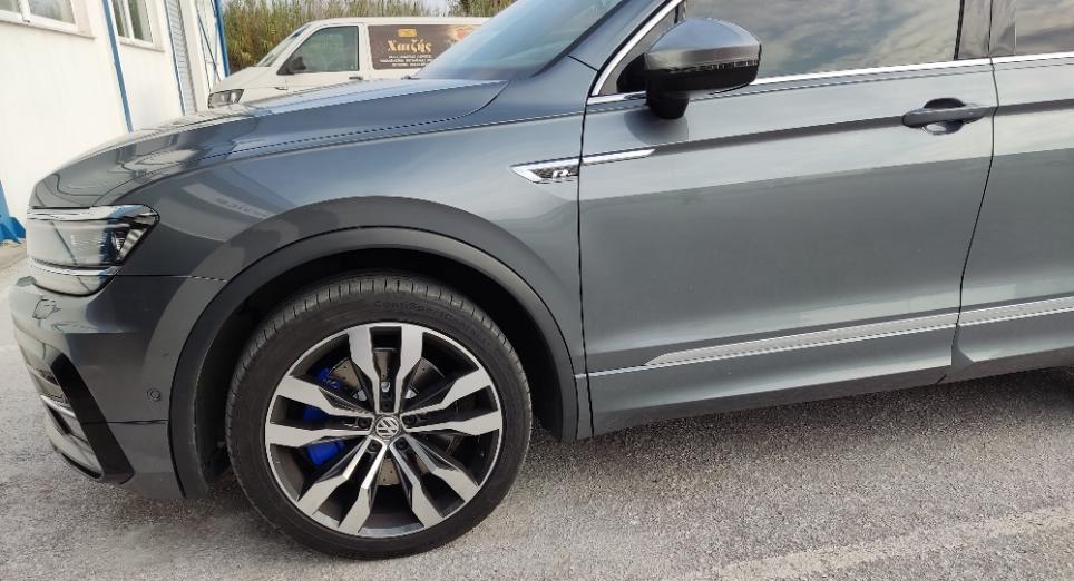

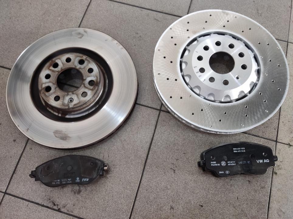

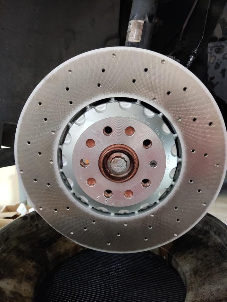

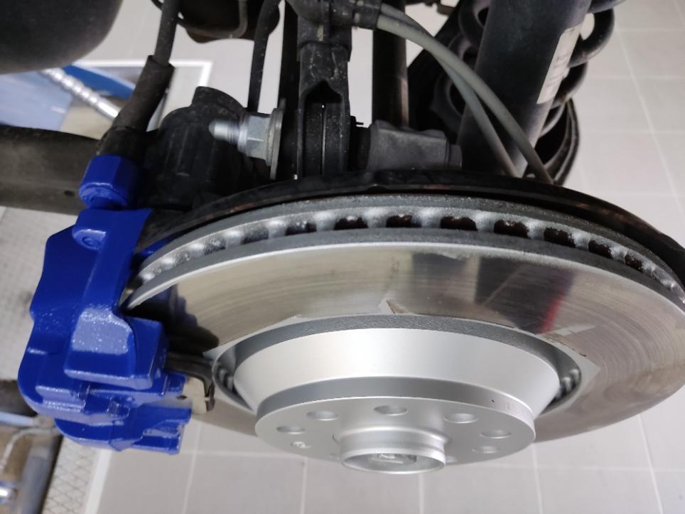

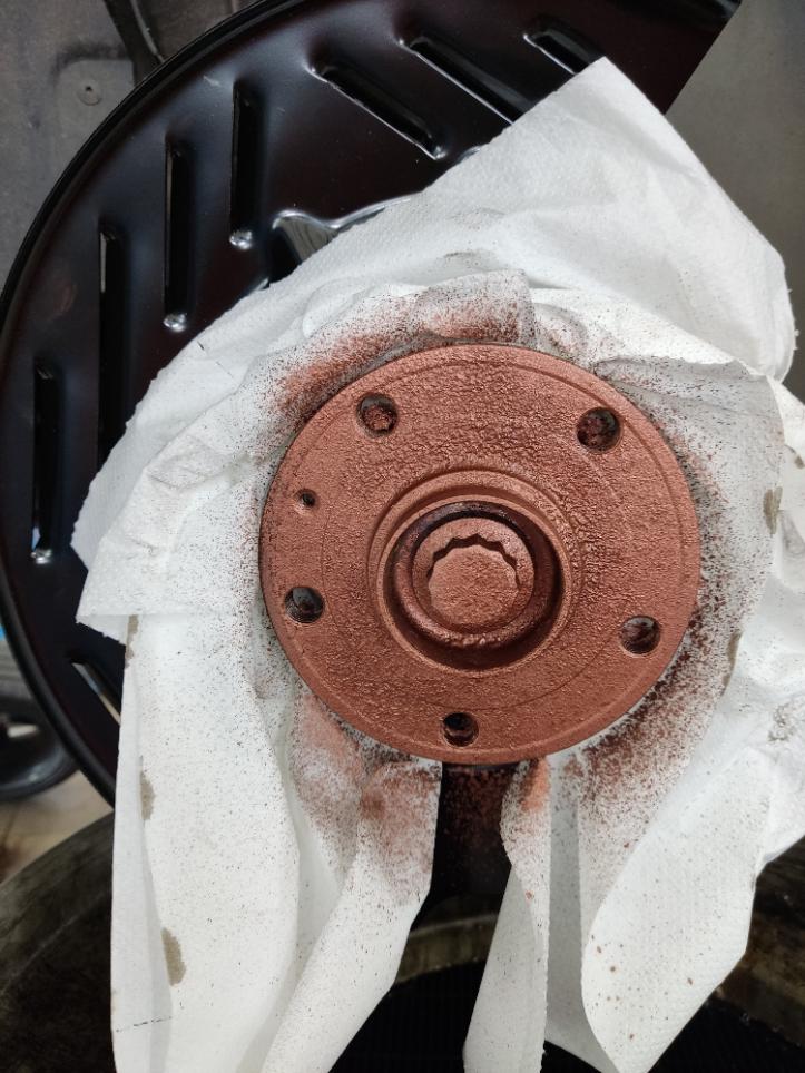

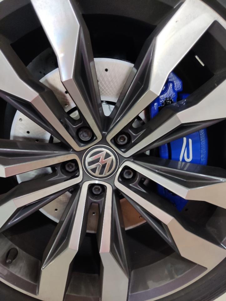

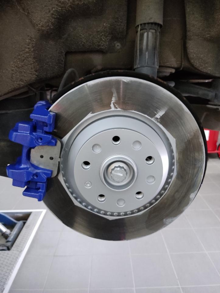

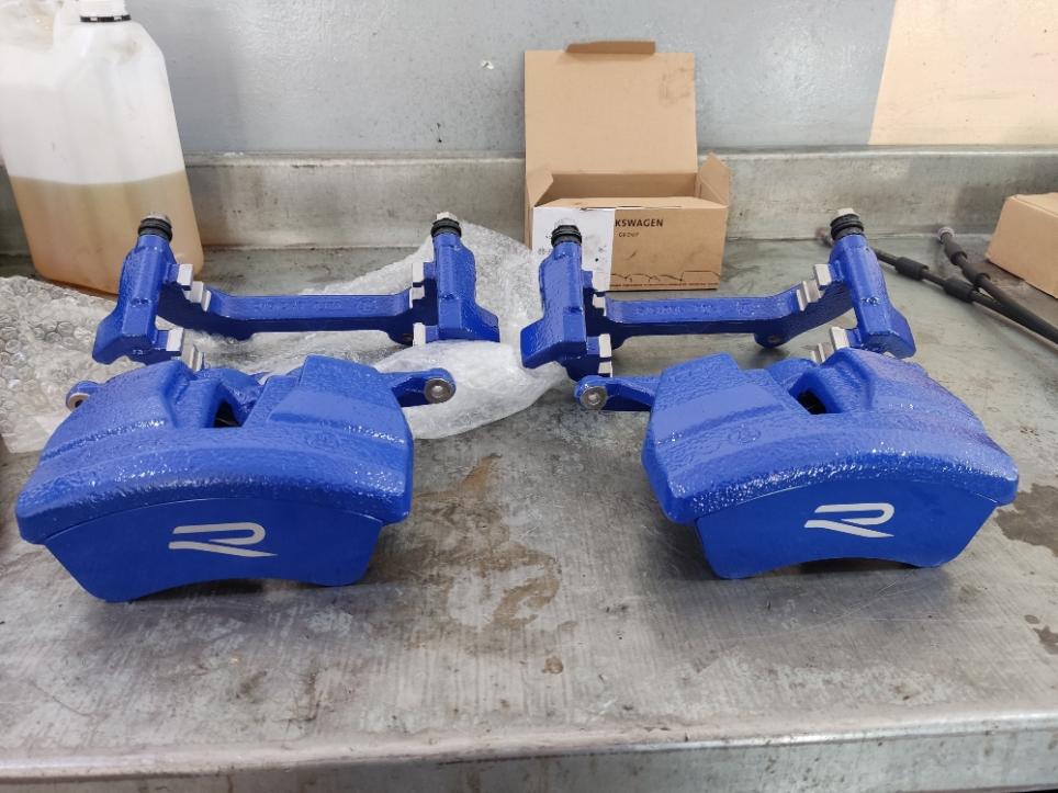

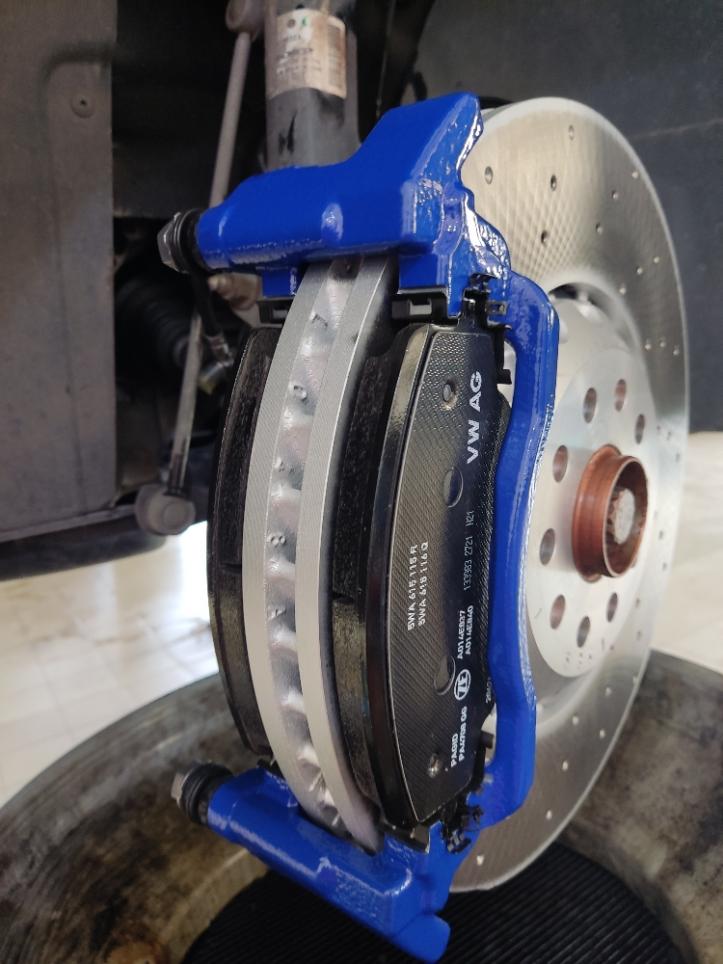

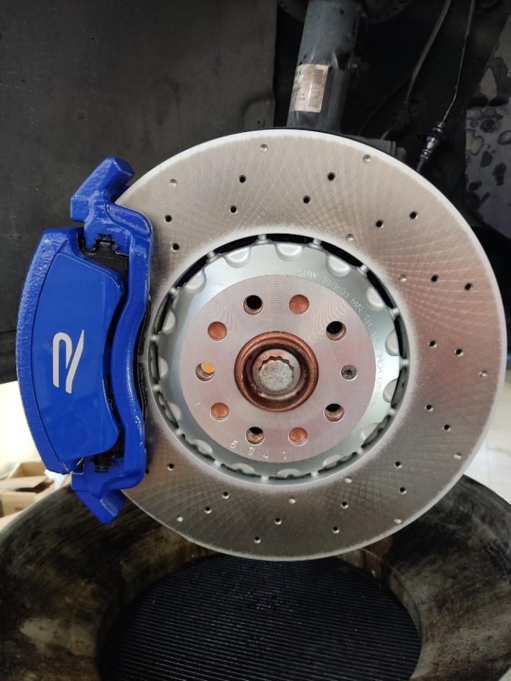

          Hi all, the operation "R front brakes" has been completed.
          Rear calipers were painted the same colour as the new R ones.
          Here are some pictures of the process.
          VW Tiguan 2.0 BiTDi Stage 1 300HP DSG7 R-Line 7seater

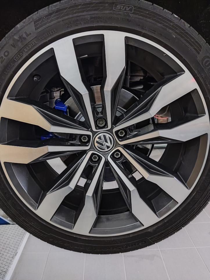

                            Well,the calipers and rotors are finally installed.All i needed were the original brake hoses from the 2 pot calipers because of the 12mm banjo bolt.The rear brake hoses from the Tig were a direct bolt on.
