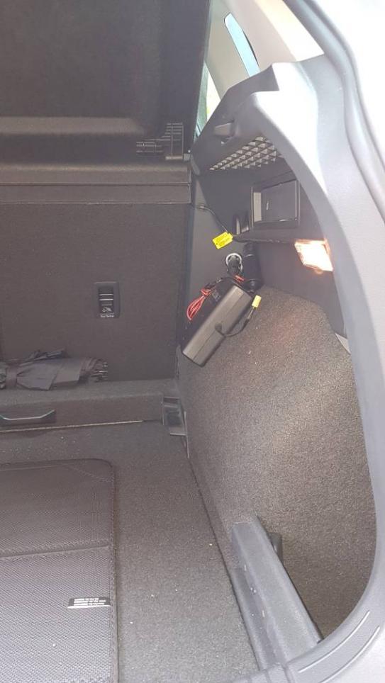

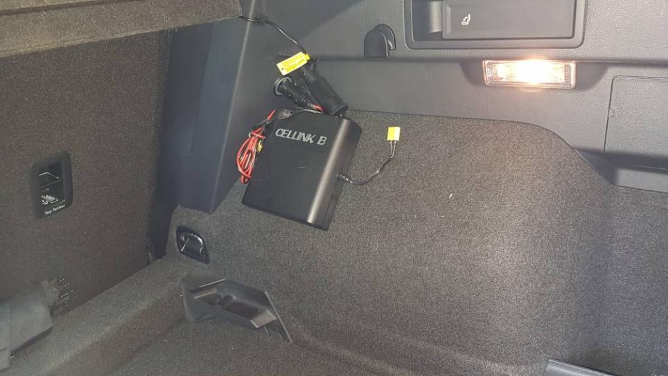

        I chose the easy way. I used the boot power socket. See attached images. It is fully reversible and works perfectly.
        Regards
        David

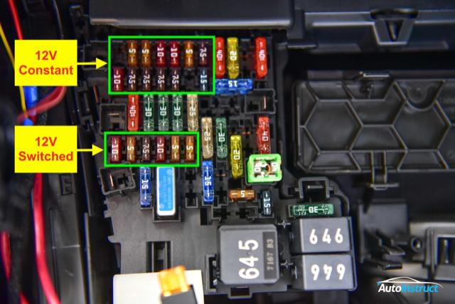

          If you want the front lighter socket to always be on, then all you do is move Fuse 40 to in line with the other fuses.
          (Excuse the shocking MS Paint job - I'm at work)

            Whatever you do DONT STICK WIRES DOWN THE SIDE OF FUSES
            Get one of these They come in standard and Mini fuse sizes. The mini also fits in a Micro socket
            Put original fuse in the bottom one and whatever your battery needs in the top one
            Meter the fuse socket to see which side has power on it an fit it as shown

                I've been looking at youtube more about hardwiring and now know that thing i need is called a Piggyback fuse Guess I'll just now need a multimeter to test for the 12V input so i dont get it the other way around.
                Too bad the official handbook does not exactly tell you what those fuses are.
