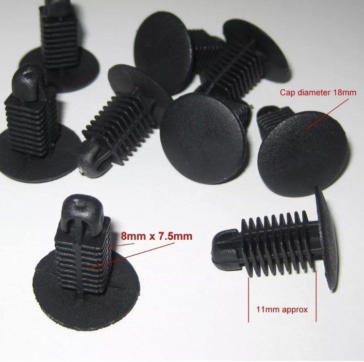

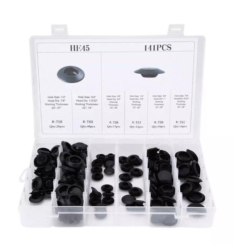

          The other options are using these automotive plastic plugs and painting them with the colour you want. They come in diff shapes and sizes and could be more durable.
            Black Wolfsburg with panoroof arriving Jan 2019
            Hey orpheus. These are what we call Christmas tree push in clips. There generally used for holding interior trims. But good idea to paint them. I’m using them to plug up the holes we’re the old air plane table tops are behind the front seats. I’ll send some pics later on.

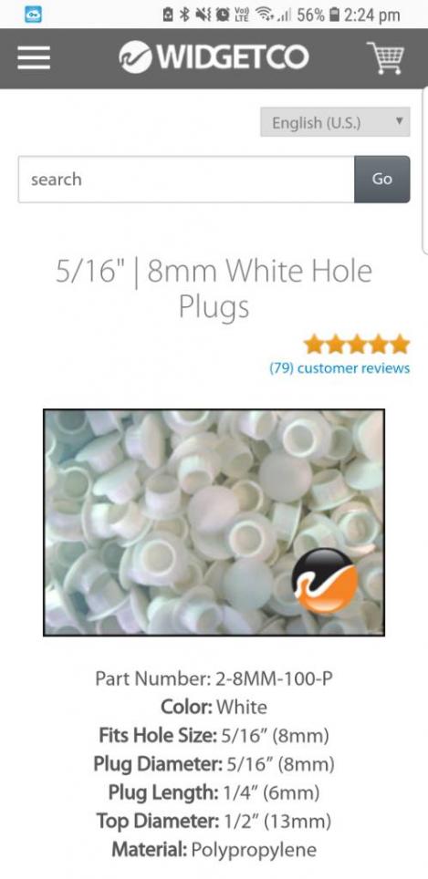

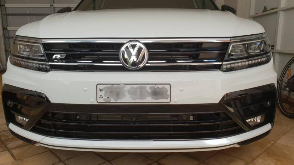

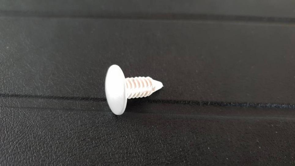

                            Just thought I would add in case this helps anybody. I removed the clunky black number plate mount from front of my Tig. Very easy but unfortunately I had 4 x 8 mm holes to deal with. I got some plastic plugs from Autobarn for a buck each and painted them up. The plugs had a bigger head than I would have liked and used touch up pens with a sprayed clear coat. White base coat - then metallic top coat before light 1000 grit sand before spraying clear. I went a bit heavy on the metallic coats so I had some sanding thickness, unfortunately this had the effect of making the plugs more silvery than they should be. The fit was not very tight so I used a small dab of hot glue to be sure. Result is quite good and not nearly as ugly as before with my small plate. I have ordered some more plugs that look better from Widgetco in US and will see if I can do better. Cheap as, but postage not. Look like they have a smaller head and hopefully a tighter fit. I will go easier on the metallic next time. I await delivery. Contemplated Bumperplugs but hugely expensive and I didn't want to risk having to drill holes bigger so I can return to stock easily. Hope this helps someone.
                              Nice work. There's quite a few different options for filling / covering the holes left and you're found a few different ones. I think the solution you have at the moment isn't bad and for $4 plus some touch-up paint who's arguing. Massive improvement. To do it "properly" you'd fill the holes and then respray the bumper but probably not worth it unless you were fixing up a bunch of stone chips at the same time.
