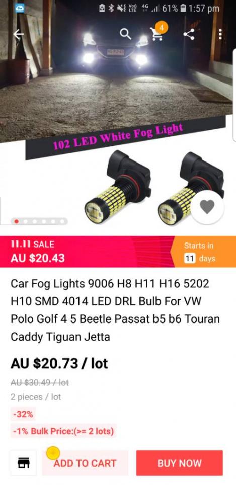

    I am also considering doing this. Apparently the yellowish colour helps to cut through the fog a bit better but that is a rarity where I live. I believe the unit is called an H8 (with right angle connector). See the attached from Ali Express. I believe these are common to most recent VAG vehicles, but again concerned about the issue with errors. I understand from YouTube vids that it is a simple task to change albeit a bit of a squeeze to access from inside the fender lining. If you browse Ali Ex you will find other sellers providing some info and claiming to be "error free"

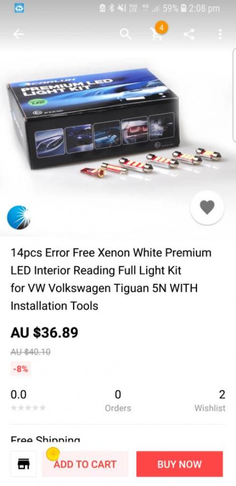

    I see there are also full LED interior light kits specifically for the new Tigs. I would be interested also to hear from wiser folks.

                    Assuming the fog light in the current Tiguan is a traditional filament bulb and not some new age LED or similar, and if it is indeed a H8 type bulb, then something like this is what you will want to get a nice white light and not have to worry about error codes.
                    PHILIPS H8 Diamond Vision 5000K White Halogen Bulb | Blingwork Automotive Lighting
                    Before buying anything, i would suggest you remove one of the bulbs and check that it is infact a H8 style bulb as there are many different shapes and sizes of bulbs.
                      This website is saying the fog lights for the current Tiguan are HB4 (9006) style.....so best to check: HB4 (9006) Car Globes | Replacement Car Light Bulbs | Powerbulbs

                          I have replaced the whole front section with LED bulbs in my Tiguan.
                          My advice? Forget Aliexpress and other cheap sites when you want to put LED bulbs in your car. I bought a similar LED bulb you had on your left picture and the LED part of the bulb broke off and it fell into the fog light housing. It took me a very patient 40 minutes to get it out. Cheap crap and it gives an error message.
                          I use Philips Ultinon H7 LED in low beam and KONIK H8/H11 LED bulbs in my fog lights. Also have LED bulbs in high beam and in my DRL and front indicators.
                          Blingworks is highly recommended as they sell quality and tested bulbs. Don't buy cheap stuff.
