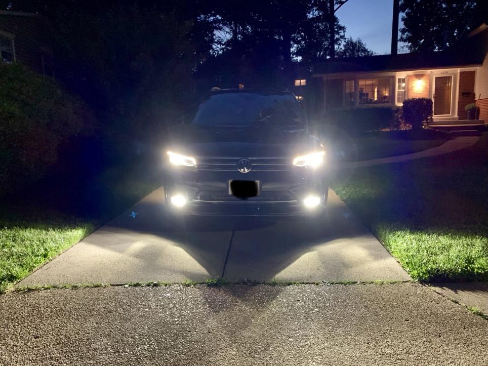

So I did this to my NAR 2019 R Line since I too hated the yellowish fogs not matching the LED headlights. I’m happy with the results and I have used them in fog with no issues. I also enabled them for turning and I like how they fill a gap between the headlights and the cornering lights. Here’s the link for the kit I bought:

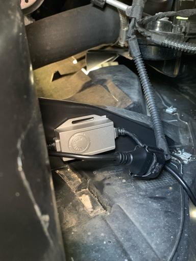

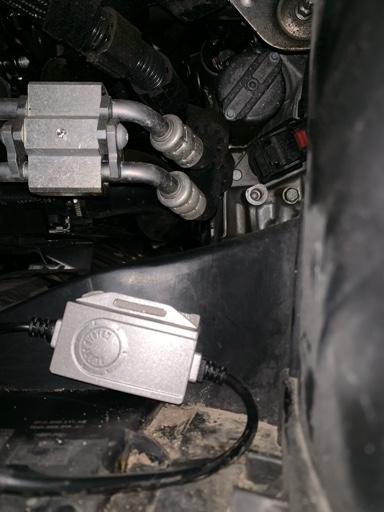

Easy to install, but recommend a second set of hands. Just unscrew the inside wheel well liner with a T20 and pull back. Turn the wheel inward so you have room in the front. LED should be at the 3 and 9 position, if at 6 and 12 you’ll get flashed by oncoming traffic. 3M adhesive for the ballast to mount, some have used zip ties. Took about 45 minutes total.

Driver side (Left hand side)
Passenger side (Right hand side)
Results
