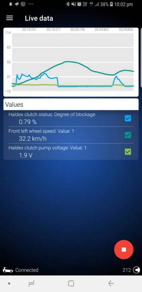

        In relation to this post, I was having a fiddle with my OBD11 and logging haldex activity. Something definitely happening when taking off, voltage increasing from 1.9v and blockage % increases.

          Yes I did some similar logging too.
          What I was trying to see was the left and right wheel speeds from stationary (1st gear) when turning. The outside wheel should track a larger arc and therefore run at a higher speed.
          What I suspect is happening is that the rear wheels are running at the same speed (locked) in first gear. Unfortunately my VCDS is not able to scan fast enough to prove/disprove this but if you can log see both speeds and the Haldex current you’ll hopefully be able to see what I suspect is happening.
