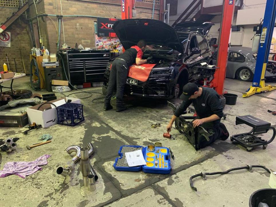

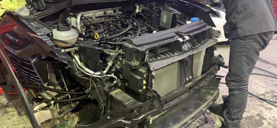

Well done mate! Great results....is38 is the sweet swap in terms of performance for $.Originally posted by davman View PostIS38 Big Turbo Upgrade Done!!!
My brief to Etuners Motorsport was:
Keep it Quiet (but not too quiet)
Keep it within budget (Total spend of $5,000 including IS38 )
Make it SAFE, and then SAFE again, and then finally KEEP IT SAFE
Then outside of that - go for your life.
The result?
Well when your digital speedo jumps up in increments of 20kph and is struggling to keep up - but then when the car is more than happy to potter around in daily traffic - then you have an amazing SUV.
So I ended up with 228kw, and about 465nm ATW
So we put in:
BMS drop in filter, and removed the snow grate. No other airbox modifications were done.
CTS Turbo Inlet
CTS Downpipe with Hi Flow Cat
IHI IS38 Turbo - New (but had been used) (06K 145 874G)
Stage 3 Engine Tune
Matching DSG Tune
I really like dealing with Gordie. He listened to what I wanted, added his advice, but wasn't over the top in his recommendations. He enjoyed the process just as much as I did I reckon - and was over the moon himself at the end result - a true enthusiast.
Thanks for everyone's input so far to help me make the decision making process easier.
Now for planning the next set of mods...........
I’ll update the front page.

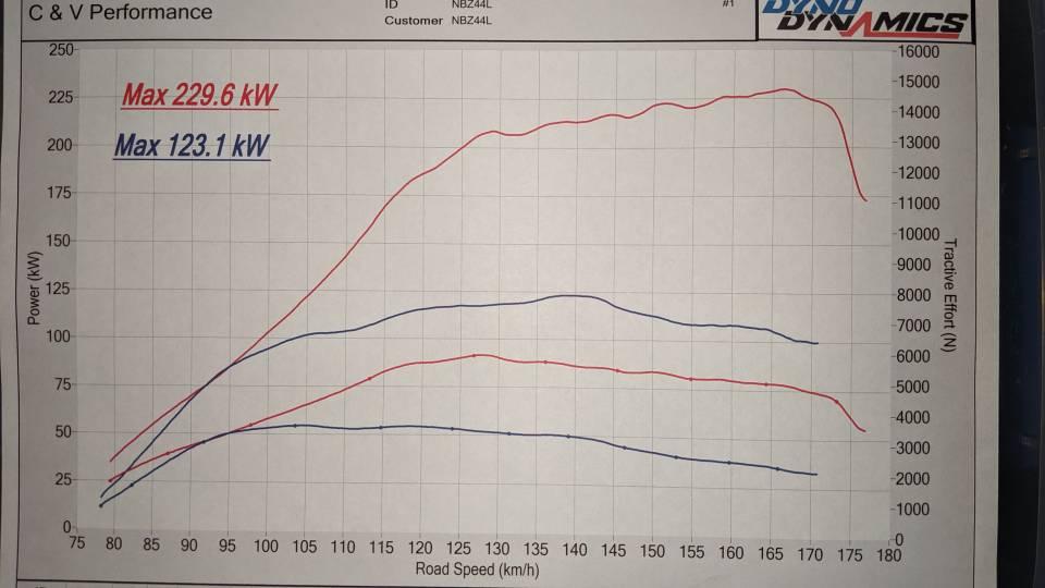

The mods are done.
I'm a little confused on the final figure when I look at what others have achieved, but nevertheless I'm stoked with how the car has turned out.
The ride height is spot on too, and while firmer it isn't rough. It's perfect.
It turns out when I took the car back the tune had been dialed back to 212awkw. The tuner had tried to explain to me he was reaching for 240+ but kept getting engine knock. I guess in all the excitement I misheard what he was explaining to me and thought it was running at just under 240 with more to come.
Everything checks out, the only way to increase it would be to up the octane I was told, but I'm not going E85. BP98 can be expensive enough as is.
Maybe it's the addition of the oil cooler, maybe it's the oil catch can?
I also suspect their dyno isn't very forgiving. When my R36 had a stage 1 it read close to 20awkw less than some others were getting.
Sent from my Pixel 3 using Tapatalk
Beedub, how it drives is the most important thing - and unless you are going to be timing quarter miles or 0-100 shootouts, then figures are just figures. Lets face it, on your graph you are losing your license before you even reach 200kw.
