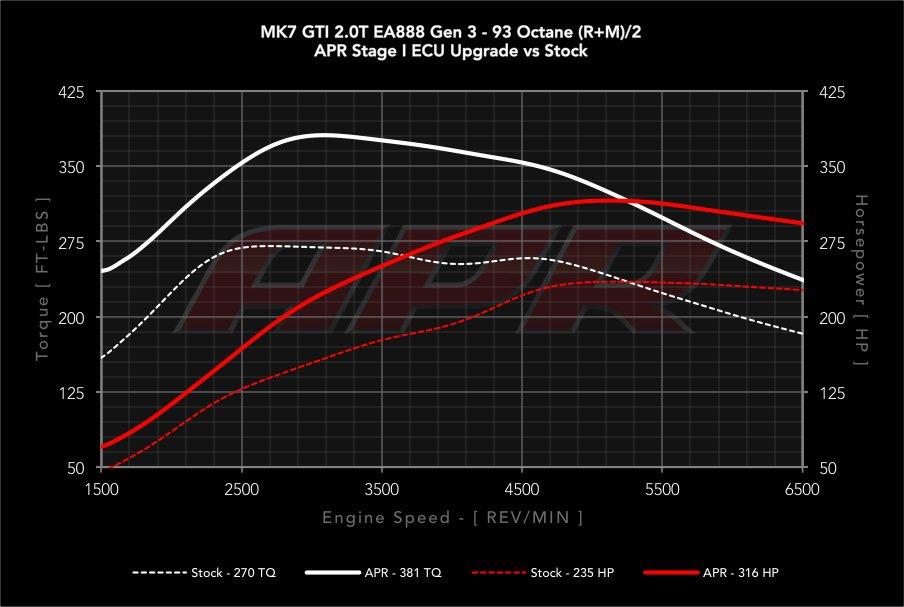

APR tunes typically are aggressive at lower RPM and tend to fall off towards Redline. It’s just the way they approach tuning and you will likely feel that at’s running out of steam in the last 1,000rpm. If you look at their published dyno charts it shows this quite clearly what you’re feeling on your butt dyno:
Different tuners will do things differently and look to pull all the way to Redline but less aggressive early. Different schools of thought and approaches to tuning.
The APR claimed increases are based on the VW published figures (which are conservative numbers) and on a “calculated” engine power. It is my belief that the stock VW number is low as they publish a curve with the “nominal” engine power for the motor and not “actual”. The APR figure is not easily verifiable as their figures are flywheel numbers and are calculated using drivetrain losses which are estimated. Personally I don’t like this approach as I’d rather real world before/after dyno at wheel figures on a real car but it seems a lot of major tuners do this which makes verifying marketing claims almost impossible. Fuel quality will also come into it but that’s another topic completely.
My own personal experience running my 162TSI on the dyno is that stock it is putting out close to 180-185kw at the fly (140kwaw on the dyno). Therefore even if you get the 235kw flywheel figure APR claims, that’s around 67hp (not 7

The apr dyno graphs are showing a US spec 2014 GTI and figures are all measured at the wheels (even the crank figures are estimated based on power and torque at the wheels). Therefore the stage 1 gains atw (approx 60kw on a gti according to apr) won't be the same on a tig because of the awd.Originally posted by tigger73 View PostWe’re still waiting for someone to do the before and after dynos to verify the APR (or any other tuner) claimed values.

Yes correct. This is the dyno chart that APR put up for the Tiguan 162TSI and is for the Golf GTI (fundamentally same motor). If you compare the figures, you're looking at 175kw (stock) to 235kw(stage 1). Both of these are calculated figures at the flywheel.Originally posted by Psych101 View PostThe apr dyno graphs are showing a US spec 2014 GTI and figures are all measured at the wheels (even the crank figures are estimated based on power and torque at the wheels). Therefore the stage 1 gains atw (approx 60kw on a gti according to apr) won't be the same on a tig because of the awd.
The total power number they state is irrelevant. It is the before and after measurements and the difference that have any meaning.
Agree that the difference is more important than the absolute values. I really put this dyno chart up to show how the APR tune tails away towards redline, which is what Boosted_GP was mentioning and is a characteristic of APR tunes. The tend to go onto boost fairly aggressive so you get a kick but the side-effect of doing this is that they run out of puff at the top end. There's no right or wrong. Some people like this and others prefer a more linear file with strong mid-range pull to redline - like a stronger stock file.
The low end torque is a characteristic of the small turbo more so than the apr tune. This characteristic will be maintained more or less regardless of the tuner. Some cars produce so much torque down low that tuners specifically limit it at lower rpm but I don't think the tig torque levels warrant that.Originally posted by tigger73 View PostYes correct. This is the dyno chart that APR put up for the Tiguan 162TSI and is for the Golf GTI (fundamentally same motor). If you compare the figures, you're looking at 175kw (stock) to 235kw(stage 1). Both of these are calculated figures at the flywheel.
The reason it tapers off at higher rpm is the turbo again. It just can't flow the air to hold boost and give what the engine is demanding at high rpm. It runs out of breath.Last edited by Psych101; 20-02-2019, 08:02 PM.
Yes to a certain extent the power/torque curve is related to the turbo. However tuning philosophy will determine how hard it comes onto boost and how well it hangs on at higher rpm. You're obviously limited by the turbo/hardware as to how much boost you can make but from there the tuner can choose how/when to request how much boost/timing/etc to add in at what point. Each tuner will do this slightly differently and map the throttle response differently also. All of this can greatly change the drive-ability of the car.Originally posted by Psych101 View PostThe low end torque is a characteristic of the small turbo more so than the apr tune. This characteristic will be maintained more or less regardless of the tuner. Some cars produce so much torque down low that tuners specifically limit it at lower rpm but I don't think the tig torque levels warrant that.
The reason it tapers off at higher rpm is the turbo again. It just can't flow the air the engine is demanding at high rpm and runs out of breath.
If you get the opportunity jump in cars with different tunes to compare and see how each one behaves. They can be quite different. Even throttle mapping can make a big difference to how the car drives and how "touchy" it is.
In my experience a tuner will find power and torque wherever it can be found throughout the rev range (particularly on a car that doesnt make much power to start with). How well they do this depends on their skills and experience which accounts for variation between tuners more so than their tuning philosophy on a tig. We are talking about an awd family suv making less than 200kw.Originally posted by tigger73 View PostYes to a certain extent the power/torque curve is related to the turbo. However tuning philosophy will determine how hard it comes onto boost and how well it hangs on at higher rpm. You're obviously limited by the turbo/hardware as to how much boost you can make but from there the tuner can choose how/when to request how much boost/timing/etc to add in at what point. Each tuner will do this slightly differently and map the throttle response differently also. All of this can greatly change the drive-ability of the car.
