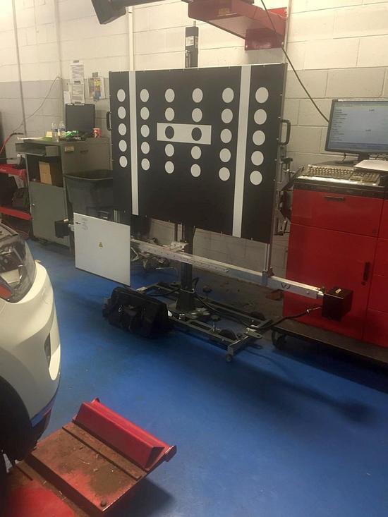

            @Bambazonke: hmm........ again, I don't have access to the wiring diagrams for the T-Cross, but I as I understand -Travel Assist combines adaptive cruise control and lane keep assist together in order to control the accelerator, brake, and steering, all independently of the driver.
            If I look @ your auto-scan report, I note that this car has a front facing camera (i.e. a hexA5 module) - so lane keep assist is already fitted. But , I can't see the front facing radar module (i.e. hex13 module which VCDS calls "Auto Dist. Reg (J428 )") in your auto-scan - this means that your car doesn't have ACC.
            Retro fitting ACC is SWAP - so yes, FECs. Also, installing the front facing radar module requires calibration. I've read forum posts that claim that calibration can be DIY - but I suggest that because of the safety implications, this is more appropriately done by a dealer using the proper tool (see below):
            Bottom line = retrofitting Travel Assist on this car will not be a trivial task - I suspect
