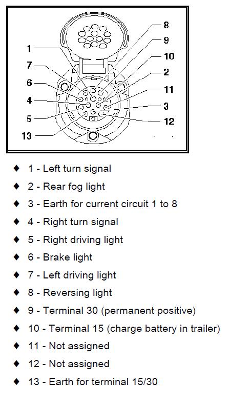

    The trailer hitch modul is 5Q0 907 383H
    Is it possible to code it via VCDS so that I can get the reverselight signal even with no trailer attached?
    Does anyone have a pinout diagram for this trailer module?
    I do not know what colour the cable for reverselight have.

      John: hello and welcome to the forum. For obvious reasons, my understanding of the protocols that VW uses in Sweden for its trailer wiring isn't good, but I assume that your car has the standard EU 13 pin socket. If so- here is the pin-out diagram
      However, if the socket is wired as standard, it will be powered by what VW calls J345 - which is the trailer detector control module.
      As the name implies, nothing happens to any of the pins on the socket unless a trailer is detected! I suspect that this is the reason for your observation " I dont get any signal at all when no trailer is attached" - because it's the job of j345 to disable the socket when no trailer is attached to the car!
      I also suspect that this is why it's probably not a good idea to get your +12v initiating signal for the new relay from the 13 pin socket
      You could of course take supply from the back of the two existing reversing lights (in the tail-light assemblies). But if you don't want to access the hatch-door wiring, you might consider a lateral thinking alternative as follows:
      1. the only permanently live wire in the 13 pin connector is pin 9 - regardless of the trailer's connection, this pin is +12 Volts.
      2. Connect one end of the the normally-open contact terminal on the relay to this pin
      3. connect the wires from your new reversing lights to the other end of the normally-open contact terminal on the relay
      4. Buy yourself a 12 Volt remote control from eBay - the kind that is "momentary", not the "latching" kind
      5. wire the receiver output terminal on the remote control to the coil of the relay - so that the relay is energized whenever the remote receiver operates
      6. on the remote control transmitter, wire together the push button contacts so that the transmitter always operates when it receives power.
      7. If you have chosen the remote control correctly, you would have purchased a transmitter that is powered by one of those small 12v batteries
      8. In place of the battery on the transmitter, wire-in an electrolytic capacitor (size is unimportant, but around 100 micro-farads should do - and be careful of polarity on the capacitor) . The reason for the capacitor is to smooth-out the CAN bus signals that are superimposed on the reversing lamp supply (the CAN signals appear on a scope as negative-going pulses and they can interfere with the remote control transmitter)
      9. Wire the positive terminal from the remote control transmitter to the positive wire on one of the reversing lights in the tail-light assembly - the negative terminal from the remote control transmitter should be earthed somewhere convenient. - Wrap the remote control transmitter in heat-shrink tubing and leave in the hatch somewhere suitable where it won't rattle.

        I know I could get the signal from the original reverselights in the hatch but I´m to exited about doing the wireing from there
        DV52
        I know the pinout configuration for the 13 pin connector that I have, but there are as you pointed out know 12V current in any of these 13 pins without having a trailer attached, not even pin 9.
        I have VCDS and I have done a few changes to my car using VCDS and the superior in this forum but I spend a couple of hours yesterday trying to figure out how to get signals out to the 13 pin connector without a trailer attached but I had no luck at all.
        I should say that the trailer connector works perfectly when I have a trailer connected. All 13 pins are doing what they are suppose to do.

          John: OK, my bad - on the mk6 that I applied my fix-to, pin 9 was live without the trailer connected. An alternative is to use the wire from the power socket inside the hatch (as the supply source for the NO contact on the relay)- The remote control solution wasn't a difficult circuit to build, but I understand if you are not confident in applying the technique.
          Alas though, it means that you will need to run a trigger wire from the back of one of the existing reversing lamps, which I personally consider to be more difficult than using a soldering iron and fitting a few electronic components!
          I'm also not sure that a VCDS cable will be much help - j345's specific purpose is to isolate the socket voltages without the trailer present - not sure that you can defeat such a fundamental function in the control module - but more than happy to be proven wrong!

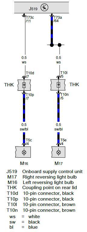

                  I got the info i needed from my local VW dealer.
                  The signal I needed for my relay is easiest to get at the hinch between rear hatch and the car ( see the pictures )
                  The Connection is called T10K and at connector number 7 you will find a Black/Blue wire, thats the one.
                  I got the 12V supply from the rear 12V outlet and the relay for my new lights are located on the left side, just under the factory toolkit in the car.
                  It all worked out as I wanted it to, thank you for all your help, info and input.

                      My bad, the connector is of course THK ( not T10K ) and it's pin 7 T10p, which is Black/Blue. I choose to get the signal from the T10d white cable because of space issues, but it's the same signal.
                      Regarding the Relay I have, it's just as a safety feature. The 20w (about 1.5 amp) would easily work without a relay, but I like relays 😜
