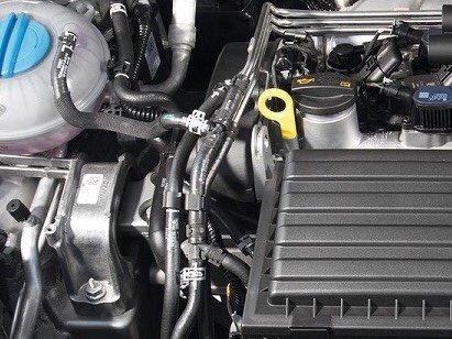

Starting a thread for the wastegate rattle in 1.4 TSI MY15 motors.
For background, this is not the same as the actuator rod rattle seen in MY13 models. MY15 models had a redesigned actuator rod which did not require a clip to stop the rattle. The mechanic recommended replacing the actuator rod at the 15k service to see if it'd remove the rattle. It didn't.
Had the 30k service done today, mentioned wastegate rattle to the same mechanic again who came for a drive and confirmed it exists.
I'm still suspecting the cause is the wastegate itself, but I was informed there is a TPI out from VW regarding a corrugated pipe connected to the turbo that could be causing the noise. The mechanic said they can't replace the wastegate under warranty until they have completed the TPI and confirm the rattle is still there. Fair enough, sounds like his hands are tied by VW processes.
Part has been ordered, will update the forum once it has been replaced.
TPI 2036393/6 <- Can someone with erWing access look this up for me by chance?
According to this forum in the Czech Republic, this is meant to be a fix for some high pitched whistling noise... https://translate.google.com/transla...-text=&act=url
