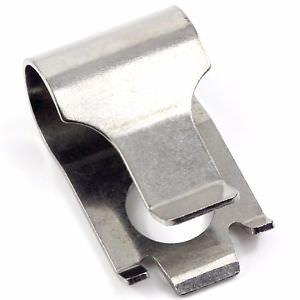

The issue is with the wastegate actuator rod, in some instances there's a bit of play so it rattles under acceleration. VW and my tuner have both advised me it doesn't affect performance but it was driving me up the wall.
VW will typically install this clip over the rod:
The issue is that they have to get to the turbo so in my case they wanted to charge $398 (the clip only costs $8!) so I waited until I installed my DP and asked the tuner to pop it on for me. It hasn't gotten rid of the noise completely but it's much better now.
