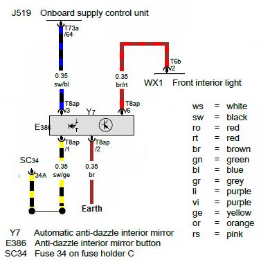

          OK - I've not installed a dash-cam in my mk7, but if doing so just requires a connection to a Terminal 15 Voltage (i.e. volts-on when ignition-on) and earth, then the VW wiring diagram says that it's possible by thieving these points from PIN #1 (+12V - T15) and PIN #2 (Earth) on the antidazzle mirror. See below - what have I missed?
