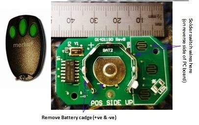

    Of course there are lots of different remote control door openers, but they basically all require the same two modifications to work on this project.;
    1. two wires need to be soldered to the terminals of one of the buttons

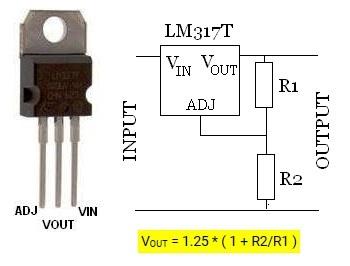

    2. Optional, but the battery in the remote can be replaced with a simple DC supply that is fed via the vehicle's battery
    In my case, the remote door opener was manufactured by Merlin (Chamberlain) . A picture of the unit is shown below

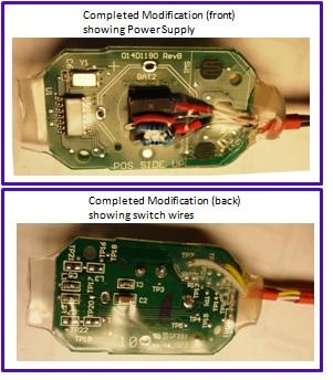

    To make the two modifications noted above, two wires were soldered to the PCB as indicated in the picture. Also I didn't want to have to replace the battery on the remote control unit, so the battery cage was removed and a replacement 3 volt power supply was constructed from a simple LM317 Voltage regulator . The circuit for the new power supply is shown in the picture below. It only needs 2 x resistors - for 3 Volts output, I used R1=360 ohms & R2=510 ohms, for 9 Volts I suggest a LM7809 regulator. For 12 volts, you could use a LM7812, but take care because this device has a drop-out voltage of 2-3Volts, so a more appropriate regulator in this instance might be a LM2940 - which has a drop-out voltage of about 0.5 Volts!
    Once the modifications were completed, the PCB was encased in heat-shrink tubing as shown in the picture below. Note that I cut-off the heat-tag on the LM317 to fit - heating is not an issue for this low power application. Also note the liberal use of glue from a hot-glue-gun as filler around the new switch wires and the throat of the heat-shrink tubing as protection against wire movement and breakage.

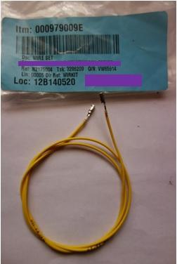

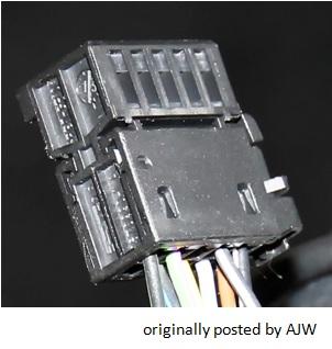

    Once the RHS switch module is removed from the 10 pin connector, two additional socket-pins need to be installed into the wiring-loom side of the connector (see picture below) on positions #9 and #10 - these are marked on the base of the connector:
    Whilst the connector itself is a special VW item, the pins on the switch module appear to be bog standard PCB pins (i.e. square 0.64 mm pins with a pitch of 2.54 mm). So the extra socket-pins are readily available from any good hobby shop (like Jaycar - CAT NO: HP1260). However, I chose to use genuine VW pins because they appear to be more robust in construction. The part number is shown in the picture below (note: only one wire is needed as it has a socket-pin on both ends - cost $15, which is outrageous!)
    To install the new socket-pins see Mattaus's video:
    Power supply for the control module can be obtained by splicing into a terminal 15 battery rail (i.e. switched with the ignition key). I sourced this supply by using a "piggy-back" fuse on position #40 of the C fuse box (the one behind the glove-box) which I had previously installed for the Auto Start Stop disable switch. I ran the two wires from the newly installed socket-pins to the C fuse box and made all the connections there. The new garage door opener is wrapped in bubble-wrap and placed in the bottom of the fuse cavity as shown in the picture below (together with the Auto SS disable switch)

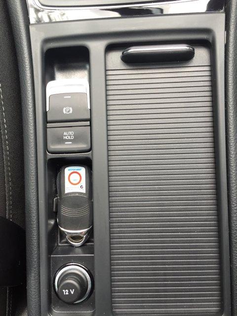

          Yeah the full integration is nice and it's a good mod.
          I decided to go this way instead and found that my Mister Minit replacement controller (for my Merlin door) fitted perfectly in this little recess in the centre console:
            Mattlock: Great solution-thanks for the feedback! I acknowledge that a different pair of eyes will see a different value in doing (or not doing) my project. That's OK - it's what makes forums like these so interesting
            Don
            PS: Perhaps I should change the title of the thread to : Show me your remote garage door opener! Interesting to see the different ways that mk7 drivers manage this very prosaic facility - I think
              Don
              Absolutely. Seeing different solutions to making our cars more usable and fun is great!

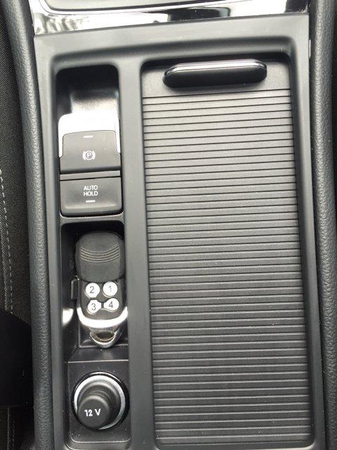

                I store mine in the right side storage compartment...

                    Originally posted by Ralfi View Post
                    Nice work!
                    Just don't forget to close it or you'll bang your shin on it, like I have several times. Man it hurts....
