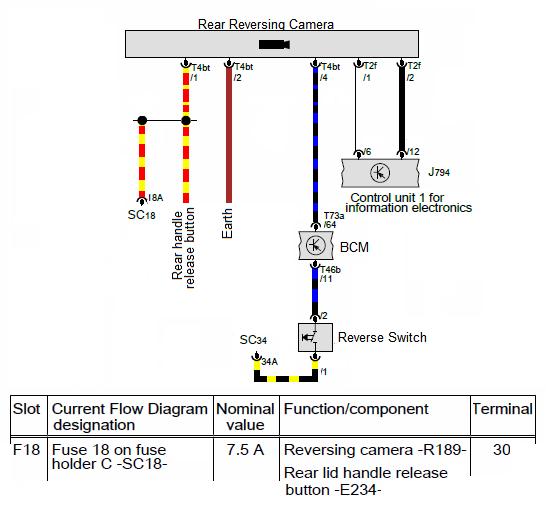

Brendan: Hello - sorry to hear about your problem! Just out of interest (I don't have a MIBII unit), does the right side reversing light work when you have trouble with the reversing camera? The reason that I ask is because the initiating signal for turning-on the reversing camera comes from the right-side reversing light.Originally posted by Brendan_A View PostIt's probably not on the high priority list with Volkswagen right now.
I had to fight for 6 months to get a new engine/ cooling system in our MY14 GTI which we no longer own. It would go months with not hearing a word from VW.
Not sure if you know about wiring diagrams, but here's my pared-down version of the pertinent bit of the circuit
You can see the that the video signal from the RVC connects to PIN #6 & 12 of the infotainment unit (the MIBII), but the initiating signal comes from the reverse switch which makes the BCM (Body Control Module) produce a voltage on PIN #64 (connector T73a - which means the 73 pin connector on the "A" socket). Now PIN#64 also supplies power to the right side reversing light - hence my question
Hope this all makes sense - sorry if I have confused you

Hi, haven't owned the car in 8 months now. Can't help you sorry.Originally posted by DV52 View PostBrendan: Hello - sorry to hear about your problem! Just out of interest (I don't have a MIBII unit), does the right side reversing light work when you have trouble with the reversing camera? The reason that I ask is because the initiating signal for turning-on the reversing camera comes from the right-side reversing light.
