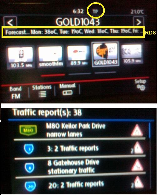

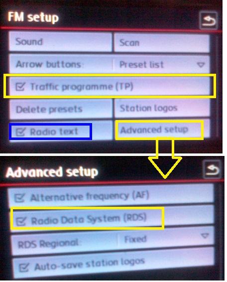

                              Hmm............... TP should be active on the 7.5 Golf. Perhaps it hasn't been set-up properly in the FM radio section of the MIB unit. You need to place a tick in the Traffic Program box (see below). If this is done correctly, you should see TP appear on the FM radio screen (see below)

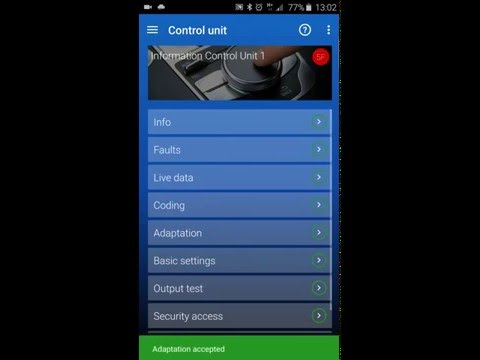

                              As for enabling TMC, which is an entirely different thing - you will need access to a diagnostic cable/dongle to do this if its not enabled from the factory. I've put the tweak instructions for TMC HERE if you have a VCDS cable
                              And the instructions for the tweak using OBDeleven are as follows:
                              You will also need to ensure that Radio Text and RDS is activated (see below). This is because TMC in Australia uses a sub-harmonic of the RDS frequency on the FM band. RDS is the carrier frequency that populates the "textual' information on the FM band screen (see below)
                              If all goes well you should see the final screen shot below when you press the TRAFFIC button (sorry for the fuzzy image)
