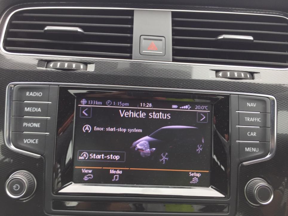

    Anyone else had this? Popped up on my trip back from the south coast today. Remedied by turning the car off and on again but I hope it's not some underlying problem that will give me grief.

      Lemonskin: Have you tried touching the area of the screen where the error message is displayed? I just wonder whether in doping so, you would get a better explanation of the fault.

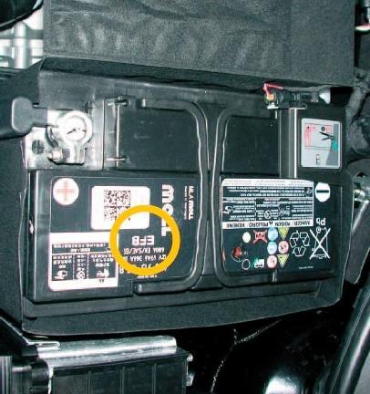

            keycol: The mk 7 uses what's called an EFB, (Enhanced Flooded Battery) which is a little different to the normal wet-cell batteries in cars (these days, these are mostly AGM, - Absorbent Gas Mat batteries) . If you pull-up the battery "cossie" and you look at the top of the battery, you should see the word "EFB" on the battery, (see pic)
            EFBs are more suited to stop/start cars because they have better "Cycle Resistance" and they have better "Layer Resistance"
            On a EFB the positive plate inside the battery is coated with an extra polyester fabric. According to VW's literature, "this gives the active battery mass additional grip on the plate". This increases "Cycle Resistance" which is the number of cycles of charge/discharge before the performance of the battery is compromised. In this way, the EFB is more compatible with Stop/Start because of the continuous cranking cycles.
            The other feature of EFB is the use of passive mixing elements in the battery which allows a better electrolyte circulation. What this does is to better combat what's called "Battery Layer Resistance" which happens when the battery experiences severe discharge (this causes unequal acid concentrations to occur at different parts of the battery which results in the electrolyte being deposited on the plates - causing lowered battery performance.)
            So, whilst I understand your concern about the additional load on the battery at night (this would normally be managed by the Battery/Alternator working together), I'm not sure that you actually need to switch-off S/S.
