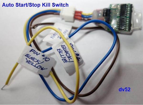

                    I'm amazed that people still try to defeat SSS by tweaking software, paying for OBD dongles etc.
                    I installed a custom made "DV52 Device" over two years ago and it has performed without fault and is instantly re-energised by hitting the button.
                    The DV52 device simply reverses the logic of the SSS so that it is set to "OFF" on start and can be set back on when required.
                    Without doubt the best solution so far.

                          ^^^^ Haha - Jimmyjames is a friend and I suspect that some of his praise for my device is perhaps motivated by our long time acquaintance!!! But thanks anyhow Jim
                          As for details about the handy-dandy Automatic Start/Stop Kill switch it looks like this:
                          DIY construction is easy and fitment is also very simple. The parts are readily available and cheap and the entire instructions can be found HERE
                          Don
                          PS: DreamensioN- the Kill switch was designed to suit a mk7 and I'm not sure if your Arteon is wired the same. The thing that's important to check is that one side of the native SS disable switch (it's installed on the center console on a Golf mk7) is earthed. Please confirm that this is so - if not you might need to use my alternative design
