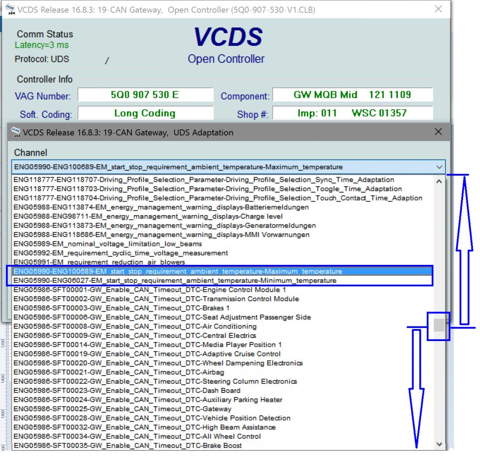

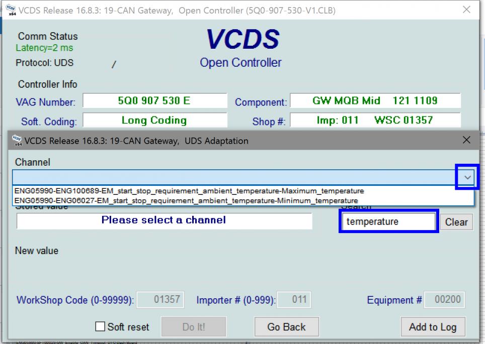

      Alex: I'm surprised that you can't find the adaptation channels in the Gateway module. Of course, your friend's car might not have both the temperature and voltagr channels, but it should have one of these.
      In the hope that it helps, I took the following screen shots using the latest RT software from the Gateway module on my test bench set-up (it's my "virtual" mk7) which only has the temperature channels:
      Notice the relative position of the pull-down box on the RHS of the picture.
      But the better method for finding adaptation channels is to use the "search" box. Just enter the word "temperature" and you should get the two channels when you press the pull-down arrow (see picture below). If you don't have the temperature channels, search for the term "voltage".
