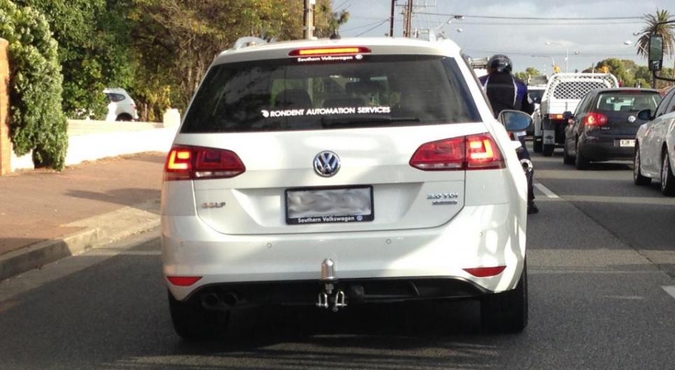

        Spotted this mk7 wagon on the way to work this week and was not able to snap a shot of the tow bar but as fate has it I seen him another day and was able to snap a shot when stopped.
        Looks like a good job but could not see any names on the tow bar like some after market ones have.

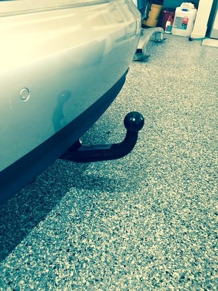

                I am getting a tow bar on my 110Tdi. My dealer sent me a pick of a tow bar fitted to one of his client's deliveries last week. See pic. It looks like the tongue can come out of the box-like socket. Hope so.
                2015 Golf 110Tdi Highline -Tungsten Silver, OEM Towbar, Pirelli P7s
                • #98
                  Picked up my car today. The "tongue" does come off and they even give you a bag to put it in!

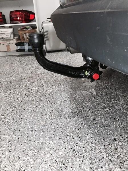

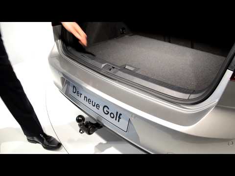

                    That's good comparison to a genuine VW German Towbar OEM Golf 7 which is completely invisible and does not require cut in the middle of your bumper:

                        • It's actually quite strange what VW Australia is doing. In Europe, you can get OEM towbar for both the hatch and wagon (happy to be corrected). The VW OEM system is quite brilliant.
                          The tow ball pivots about a point hidden in the rear bumper. When the owner pulls a leaver in the boot, the towball swings out from under the bumper through a hole that's factory cut in the bumper (it's under the bumper, can't see it). It's packed away the same way in reverse order.
                          My Australian spec Golf wagon has the hole in the bumper, but VWA doesn't offer the towball option. Yet they offer to fit an aftermarket towbar for the hatch that requires a hole to be cut in the rear bumper (visible hole), and looks like ****. Really don't know what they are thinking / doing in the towing department...
