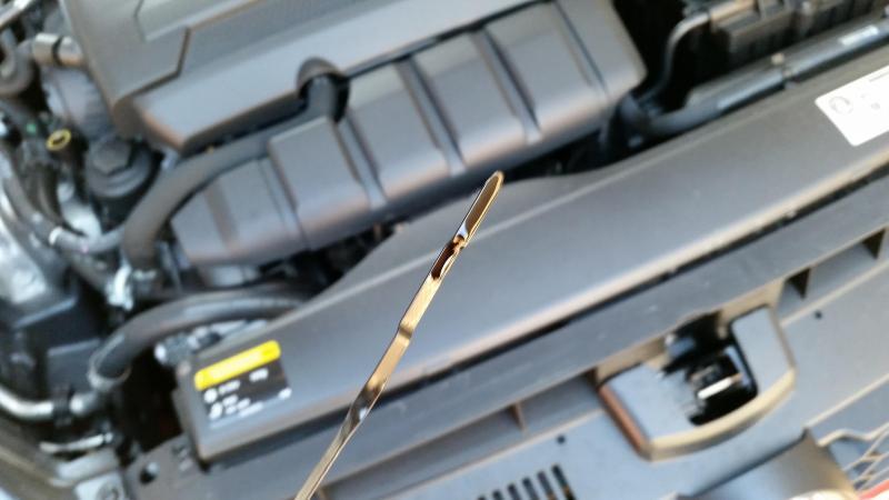

For starters you shouldn't hold the dipstick facing up, oil will run down the dipstick and give a false reading. From that picture it looks like its on the lower limit. Oil should be on the second kink on the dipstick.Originally posted by Lemonskin View PostSo yesterday, my GTI bleeped at me saying "CHECK OIL!!!" with 5,500km on the clock. I didn't have tine to do it yesterday so I got the thing home (about 20km), then drove to work this morning (another 23km) and finally checked the oil this morning. The result?

It's actually being held flat, must be a trick from the way the shot is taken. Is it really on the low end of the scale? My Polo had a very different dipstick and a reading that looked like that on my Polo would have been bang in the middle, probably about ¾ of a litre left.Originally posted by Brendan_A View PostFor starters you shouldn't hold the dipstick facing up, oil will run down the dipstick and give a false reading. From that picture it looks like its on the lower limit. Oil should be on the second kink on the dipstick.

Ok sorry mate. Yes, it's Definitely on the lower limit. Oil should be on the second bend. Did you check the oil straight after diving or wait say 30mins?Originally posted by Lemonskin View PostIt's actually being held flat, must be a trick from the way the shot is taken. Is it really on the low end of the scale? My Polo had a very different dipstick and a reading that looked like that on my Polo would have been bang in the middle, probably about ¾ of a litre left.
My GTI got 5200 on it and hasn't used a drop.MY20 Golf GTI TCR
MY20.5 LR Defender P400 HSE
I checked it about 8 or 9 mins after driving, so not long after, but I thought long enough for most of the oil to have flowed back?Originally posted by Brendan_A View PostOk sorry mate. Yes, it's Definitely on the lower limit. Oil should be on the second bend. Did you check the oil straight after diving or wait say 30mins?

I usually wait 30mins or first thing before starting. Check it again before you drive home this arvOriginally posted by Lemonskin View PostI checked it about 8 or 9 mins after driving, so not long after, but I thought long enough for most of the oil to have flowed back?MY20 Golf GTI TCR

Will do. Still, seems a little quick to be needing oil after only 5,500kms? Admittedly they have been largely city km's, but still, seems like it should go for a few thousand more km's before needing oil...Originally posted by Brendan_A View PostI usually wait 30mins or first thing before starting. Check it again before you drive home this arv

The engine and oil needs to be warm to check the oil. The manual says to have the car at operating temperature and then wait a few minutes after turning it of before checking.
Manual also states that 500ml per 2000km is acceptable usage. Much better than the Polo GTI which is 1l per 1000km.
