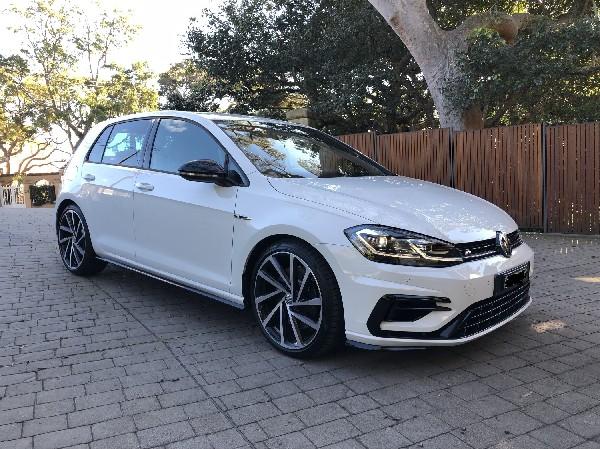

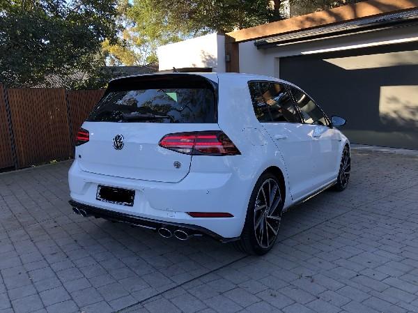

                            • Picked up my manual Golf R Grid this morning, haven't been able to get the sh*t eating grin off my face all day. What a beast!

                              • Beautiful, congratulations and well done.
