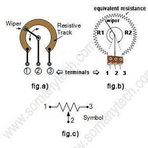

            But it really doesn't matter - if any of these non-OEM unts use an adjustment facility (like the fittings in your link), the variable component will likely be a variable resistor. This means that the variable device will use a "wiper" that makes contact with a fixed resistive track - like this:
            The thing about using a variable resistor in a car is that the environment is fairly harsh. Of course it depends on the quality of the variable resistor, but the contact of wiper-arm on the resistive-track can often become problematic with time (normally detritus gets stuck on the wiper arm). Often, simply moving the wiper can fix these problems -for a short time
            You don't say, but if this problem affects the turn-signal fittings on both car-sides (which are independent of each-other) - the fault is suggestive of poor manufacturing quality and/or sub-standard components!
