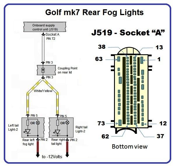

      @wookie: Yes, you are 101% correct!! Here is the wiring diagram for the rear fog-lights on LED tail-lights for both LHD and RHD cars:
      So, notice the pin label on J519 (which VCDS calls "BCM" and OBD11 calls "central electrics module"). Socket A, pin 72 is the pin that is controlled by the Leuchte-set that you refer-to as "LA72". Also note: although my drawing shows 2 x White/Yellow wires - there is only ONE wire for a given drive-side car (the drawing is illustrative ONLY)
      What happens is that the same wiring is installed on Golf mk7s regardless of whether the car has left-Hand drive, or right-hand drive. The ONLY difference is that the white/yellow wire terminates on the tail-light fitting that matches the drive side. This means that "LA72" is used to control the rear fogs regardless of drive side (albeit that "Yankee" model mk7.5s have a different arrangement)
      And to answer your specific question - alas NO, there are no active components in the passenger-side fog-light position in Aussie models
